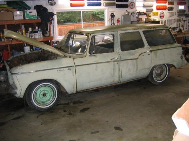

      It's a made up name for a made up product [)]. I color sanded and buffed a '60 Lark wagon that still had the original paint on it.
      Before...

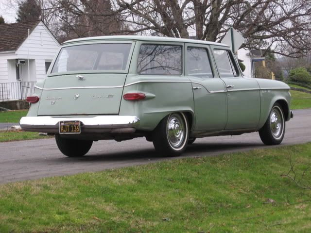

      After...
      It came out so nice that Guido and Matthew figured I must have used a top secret product and named it "Lark Shine" (pat. pend.)

            I "color sanded" with 1500 grit wet paper. I just used the paper in my palm as opposed to the right way which would be to use a block. I sanded until the old, chalky paint was gone, but before I got into the primer (hopefully [:0]). Then this Makita...
            http://www.makita.com/menu.php?pg=product_det&tag=9227C
            with a fairly aggressive wool pad
            along with this...
            http://www.meguiars.com.au/productde...subcat=&show=2
            The Makita can get you into trouble quickly. It is quite powerful and unforgiving. Go over an edge wrong and you'll be down to shiny metal in no time.
