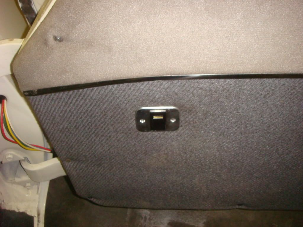

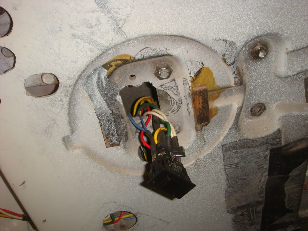

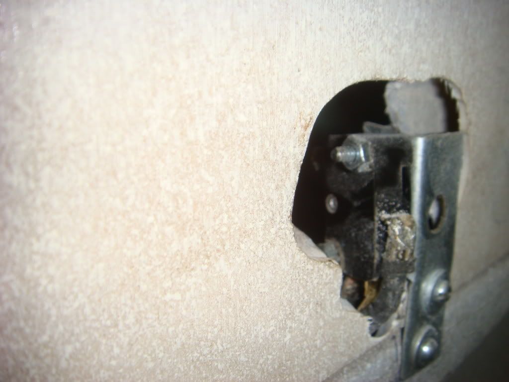

    I have been having all sorts of problems getting the stock power window motors to work properly in my Avanti. I finally gave up with the stock motors and found some other motors that seem to work better. They are from a 90s ford taurus. I was also concerned with the motors over stressing the fiberglass door panel that are so prone to cracking. I replaced the stude motor and reducer with the ford motor and reducer unit. I also added limit switches to prevent over travel and further stressing the door panel (one going up and one going down). I didnt have switches when I got the car so I found some monentary double pole double throws that seem to work good. I also had to make a plate to mount them in. I just thought I'd show you guys that there are alternatives the the slow unreliable avanti power windows. These are now very fast, and almost as quick as a new car.
    Lower limit switch
    Upper limit switch
    Switch
