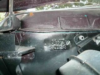

    Can anybody tell me anything about this car??It is a 1950 Champion but that is all I know... Can you tell if it is a Regal or Delux or what??[?]

    9G says that it is a 1950 CHAMPION
    F Indicates that it is a 2 Door Sedan with F1 being a Custom model
    F3 is a Delux
    F5 is a Regal Deluxe
      It's a 1950 Champion 2 door sedan "Custom" according to my manual for the F-1 designation.
