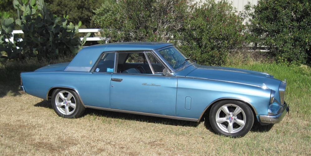

            The Mustang wheels easilly fit on the rear of my GT with 235-55-17 tires (stock for a 2017 Mustang), with no issues. On the front I have a 1 3/16" spacer to bring the wheel hub closer to center, and my brake rotor hats are a bit thicker than a brake drum. The rim hit the zerk fitting of the outer upper A arm pivot when turned to full lock. I removed the zerks and replaced them with pressure plugs which don't extend beyond the surface.

              These are the Mustang wheels on my 74 Avanti. They are 17" X 8" with about a 4 1/4" back spacing IIRC. They work on the front but just barely. I need to replace the grease zerk with a pipe plug to get them clearance but they are fine otherwise. I believe this backspacing ran from 99-04 the later ones have even more.
              Check the backspacing on the ones you are looking at and go from there. There are any number of ways to bolt a plate to your hub and look at rim diameter and back spacing both front and rear. Be sure to check the fronts from lock to lock.
