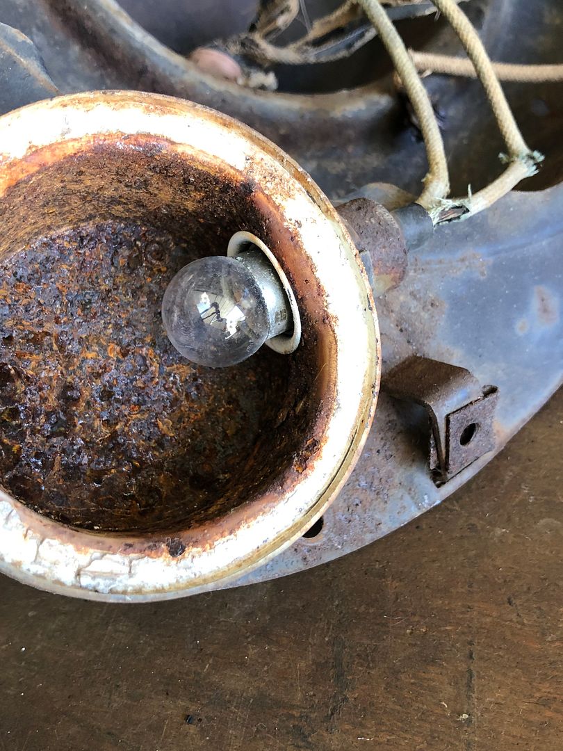

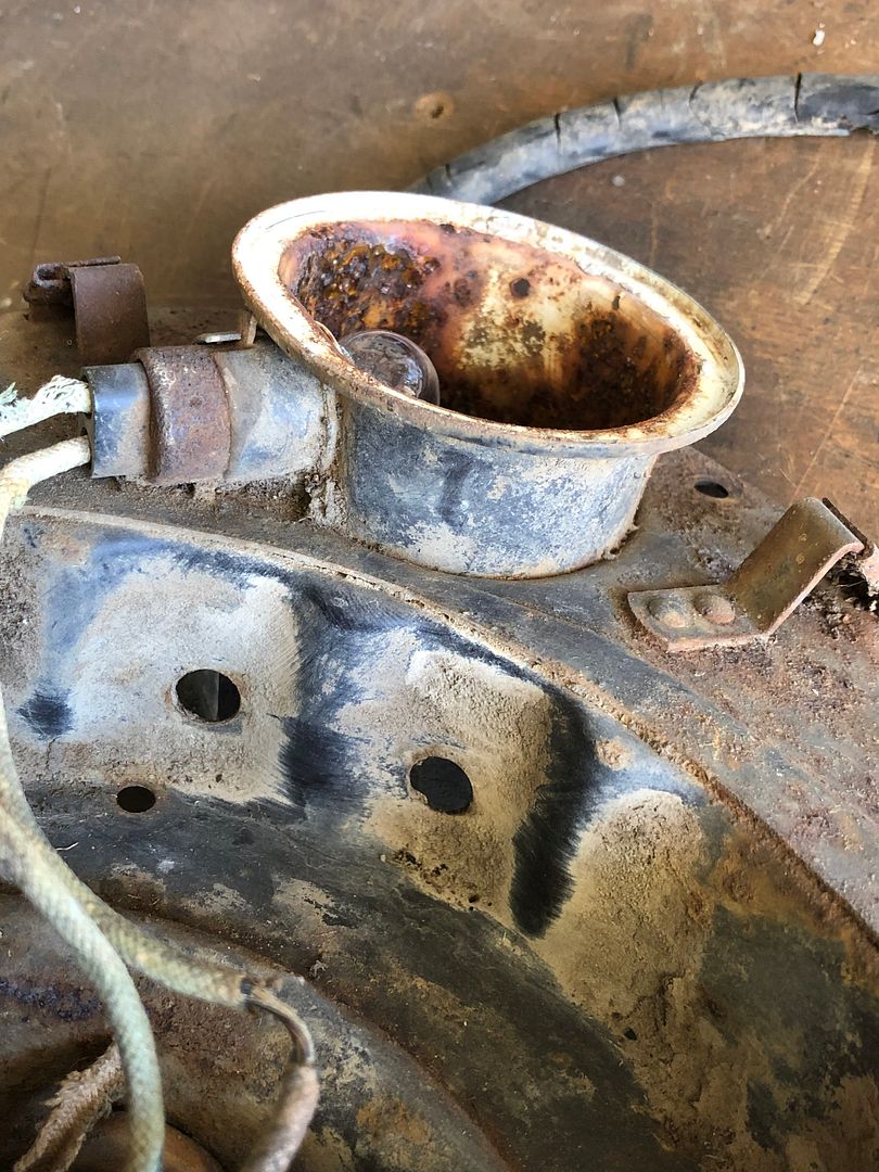

    I'm re-conditioning the headlight buckets on our 1950 Champion. Before I start applying pressure in different ways to remove the bulb, can someone enlighten me in how it is installed? It is very firmly in place. I'm sure it is rusted in place, due the condition of the rest of the bucket, as you can see. Damaging the wiring is not a problem as all wiring is being replaced. I did this thirty years ago on our Starlight Coupe, but I don't remember the details.

    The bulb is a standard bayonet, push in and twist CCW-type. Unfortunately it is probably rusted into place. Wear gloves and safety glasses when you try to remove the bulb. It might be best to soak it in penetrant for a few days, then dry off the glass so it's not slippery.
    The socket looks like a reverse bayonet - push in and turn CW. After much soaking, that is.

      penetrating oil.
        If they are really stuck, just break the bulb and fold the brass portion inside of itself with needle nose pliers. Good luck with it.

              Thanks for the great input. I got the bulb out as a little wad of crushed metal. Now to get the rust cleaned out of the socket. My question now, if I may, is the part number of a bulb to use. The photo below is our '50 Starlight with the parking /turn-signal bulb. It has a 6V 1158 bulb. This car will be 12V. The 1158 has two guide tabs, both equal distance from the contact end of the bulb. I need a 12 V bulb with the same configuration.
