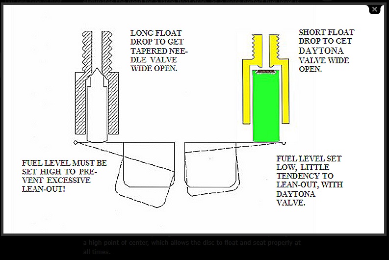

                      Possibly you have a more modern needle and seat made for ethanol based fuels.. Like this one:
                      https://daytonaparts.com/daytona-car...oat-valve.html
Name:	Daytona Carb Needle and Seat.jpg
                        Yes, that's exactly the one. I was surprised at how little clearance there is around the needle for the gas to flow in, but then Studebakers sip very little fuel compared to other makes.
                          Sorry Gary. I started the thread in the General forum more as a conversation or blog. This was to address the issue.
                          You are partly right as to the issue with the old hose and detritus in the valve body. However, even after it is cleaned out, the electric is overloading it. The mechanical pump seems to be fine with it though.
                          Jeff, thank you for that illustration. It seems Mr. Tee-Bow knows what he's doing all right! Not that I had any doubt anyway. I just thought the needle should have looked more like on the left than it does like the right. When I compared the two and examined them closely, it was obvious the difference between them. My usual assumption is that I screwed it up, as per usual.
