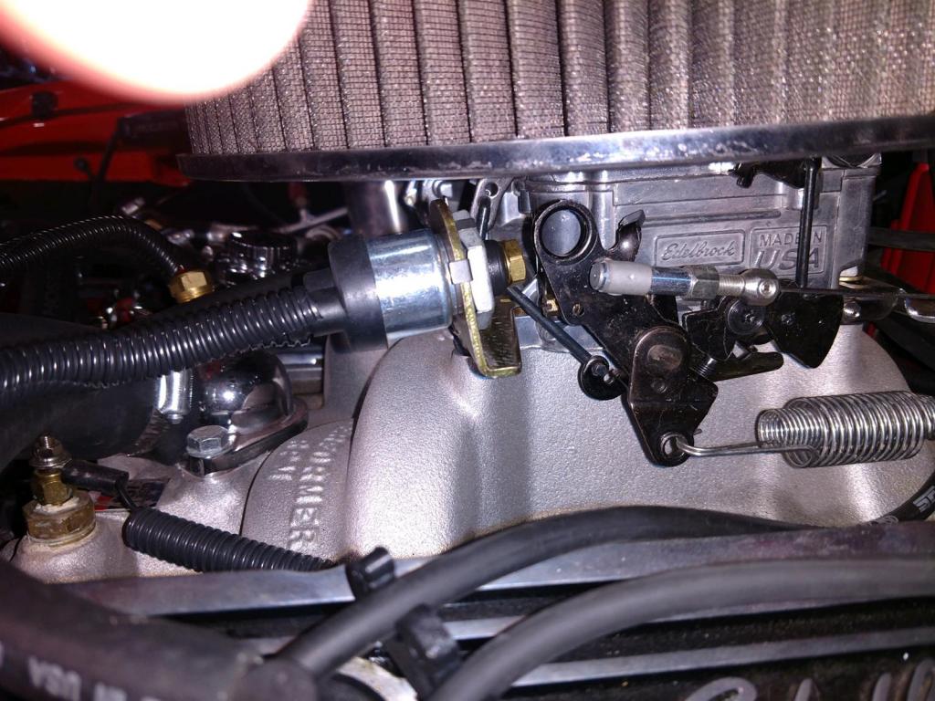

          Just installed one of these on an a/c equipped Avanti for a guy.
          He loves the difference it made. (That and the gutted heat riser valve)
          Edelbrock p/n# 8059

              Jeff me stupid.....when I swapped in a new Edelbrock 4103 (500 cfm) I not only cut off the bottom of the linkage to allow no interference with the intake runner, but I removed the top round hole portion of the linkage.....if I install this kit, I was told by the Edelbrock tech that the solenoid needs that portion (round hole portion) to hit up against.....now I have to figure how to fashion some kind of thin metal piece to allow the solenoid to hit up against.

                Look here:Click image for larger version
Name:	edelbrock kicker.jpg

ID:	1721262 Look at this
                  Informative. This gadget appears to take the place of the dashpot. Bet it works.
