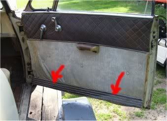

    I need to ask, what is the proper way these lower kick plates are attached to the door?
    Mine have so many holes drilled in them its hard to tell what was happening here once.

    I believe they had rectangular clips that had long "prongs" stamped into the clip. These prongs pushed through the door panel- and were folded over the cardboard. Then the door panel was installed to the door using the push-in type clips that go into the holes around the outer perimeter of the interior door face.

      What Ray said.

        Hmmm. Well, I guess the 470 holes drilled in mine were added later. Kind of figured.
        No surprise, they were laying in the trunk when I bought this basket case 10 years ago.
        Thanks for the fast answer.
