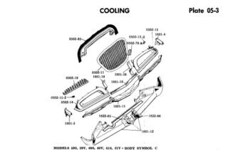

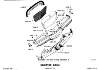

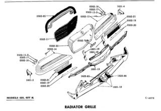

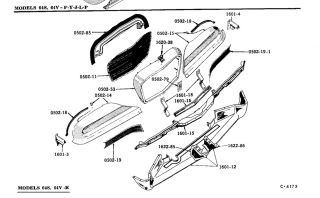

                    Hope this Part Book images helps.
                    53-57
                    58
                    59-61
                    62
                    63
                    64
