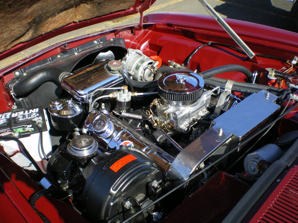

    Hello,
    This is actually Part 2 of my 1403 Edelbrock conversion experience on my 1963 R1 Avanti. Part 1 will be come later as I still need to document everything that I did.
    The following are the final part numbers used in the Air Cleaner Assembly set up. The Air Cleaner base is that from a Edelbrock Air Cleaner Assembly Part Number 1221. Again, I just used the base only from that kit. Next I used the K&N Air Filter Part Number E-3740. The Air Cleaner Top is from Mr. Gasket Kit Part Number 1480. I have plenty of clearance between the hood and the top of the Air Filter Cover. The car runs amazing now. I had put the original Air Cleaner Cover back on prior to the Mr. Gasket cover, and it just wasn't getting enough air, BOY what a difference now, the car moves!!! In fact, I think the people that restored the car never had any fun with it. That was back in 2008. When I had the Ole Girl barreling down the road I opened the cabin vents and sand blasting media blew out all over inside. I think its pretty obvious that the person that sold the car to me never actually drove the car as he stated. WOW!!! What a joy to drive!!! I hope this information helps, I know people have asked how or what to do when making the Edelbrock conversion, so I wanted to make sure I passed along what worked for me. I have some great pictures and will have more details on my Facebook Page "Cedar Hills Studebaker" https://www.facebook.com/groups/559122340944750/

    Nice! I had the same experience with my Lark; that new Edelbrock carb is very responsive and the engine runs so smoothly at both idle and at speed. Now I need to get dual exhausts!
      Yeah the Ole AFB will get a good cleaning then it will go in the living room display case.

            I can still use the original cover for shows if I decide to. I don't see how the new air cleaner set up is going to be detrimental to the engine. The base used is the same diameter of the one that SI is selling for this conversion. Going to the open face allows it to breathe so much better and its not running so rich now. Its like a whole new car, by that I mean it accelerates better, the engine noise went way down and you can hear the exhaust noise in the rear now. It made a huge difference for me. Plus it eliminated about 5 pounds of weight, LOL. The original covers are not light.

                      Okay, I am only passing along informtion, so that others who are considering something along the same lines that I have done. It might help them save some time and money? I am not telling anyone to change from originality. I ran an open face air filter for years on my '62 GT Hawk that I drove as an everyday car. It went though rain and a major blizzard back in the mid 90's here in Nebraska. Never had moment of trouble with it getting wet. It was a paper element too, so if it would have got soaked I think it would have ran like garbage due to restriction. The paper never deteriorated over the years either. The car I am working on now is a very nice Avanti, that will more than likely never see rain or a garden hose.
                      Again, my findings with this set up is better performance, and a reduction is noise from the from. I had a passanger and they said the same thing.
