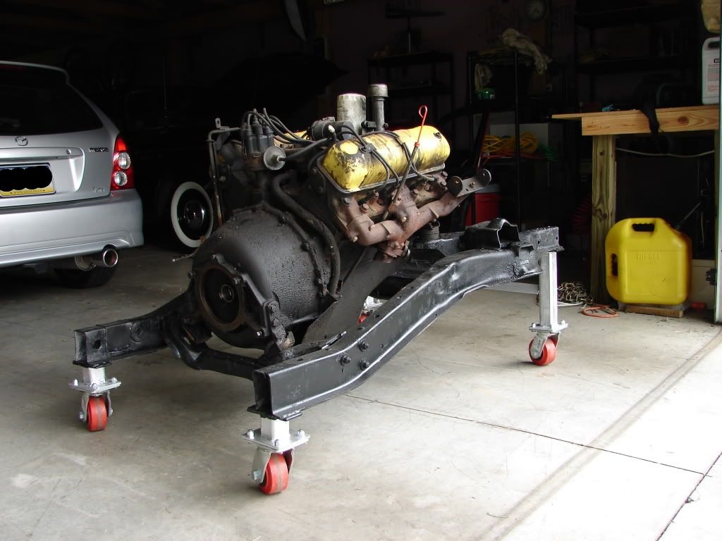

    Then I started thinking about the engine stand I had built and finished up with this last spring.
    Wish I had the facilities and know how - a frame a little longer for 3sp tranny and enough room for the generator and someone might be in "the light" pretty easy. You could even leave the front suspension on and come up with some type of rear wheel system (frame might be too long if you kept the stock rear axle location.) There are people giving away Champion and even 259s that could be utilized for this.
    Fan shroud, six bladed fan, governor, and kill switch for low oil pressure/excessive coolant temperature and someone would be set - you could hook your neighbors up as well. (saw a another one that was 50K watts for little over $4500).

        It is a romantic notion, but if you were going to the trouble of building something like this, I think you would be farther ahead with some sort of modern powertrain. It doesn't seem like a good idea to go out of your way to use antiquated technology for a modern tool like this.
        I love the Studebaker engines, especially the little Champ 6 in my Lark; but I would be hesitant to build equipment upon which I would be relying to run at a sustained RPM for hours or days. That's 50 year old metal that will certainly fatigue over the decades. The varying pressure/rpm of gentle driving is one thing- the grind of driving a constant generator is something else altogether.

              This is something that would make sense, if you had a spare engine lying around, and a spare generator. A Stude V8 driving a 10 or 20 kW generator would just be loafing, especially if you used an 1800 RPM generator, or used a belt drive to run a 3600 RPM unit. You would have to have a governor, or engine speed, and hence power frequency would change as loads were switched in or out. If you are in a climate where home heating is needed, put the radiator inside the house, and run insulated hoses to it, and let the waste heat from the generator contribute to your home heating. That's what "co-generation" is all about.
              But, if I was expecting to run a generator a lot of hours on a regular basis, I'd want a Diesel engine, for longer service life, and lower fuel consumption.
              And be sure to have an electrician install a transfer switch, so that when you are running on generator juice, your home is isolated from the power line. Otherwise, you might wind up backfeeding the line, and kill some poor lineman, or simply overload your generator. On the few occasions when I have had to run my little generator, I have pulled the line switch at the pole, and padlocked it, before hooking up the generator.
                Diesels are far more economical for generators & diesel fuel stores SO much better than gasoline. When you need a generator when the power goes out, you may not want to take the time to rebuild the carb, clean the tank out, replace the fuel pump or make a run for fresh gas.
                I have read that IHC/Ford 6.9 engines are very popular for larger generators because of their ability to run at constant rpm's, while some other diesels designed for vehicles do not last long at constant rpms.
                My preference, though, is propane for generators.
