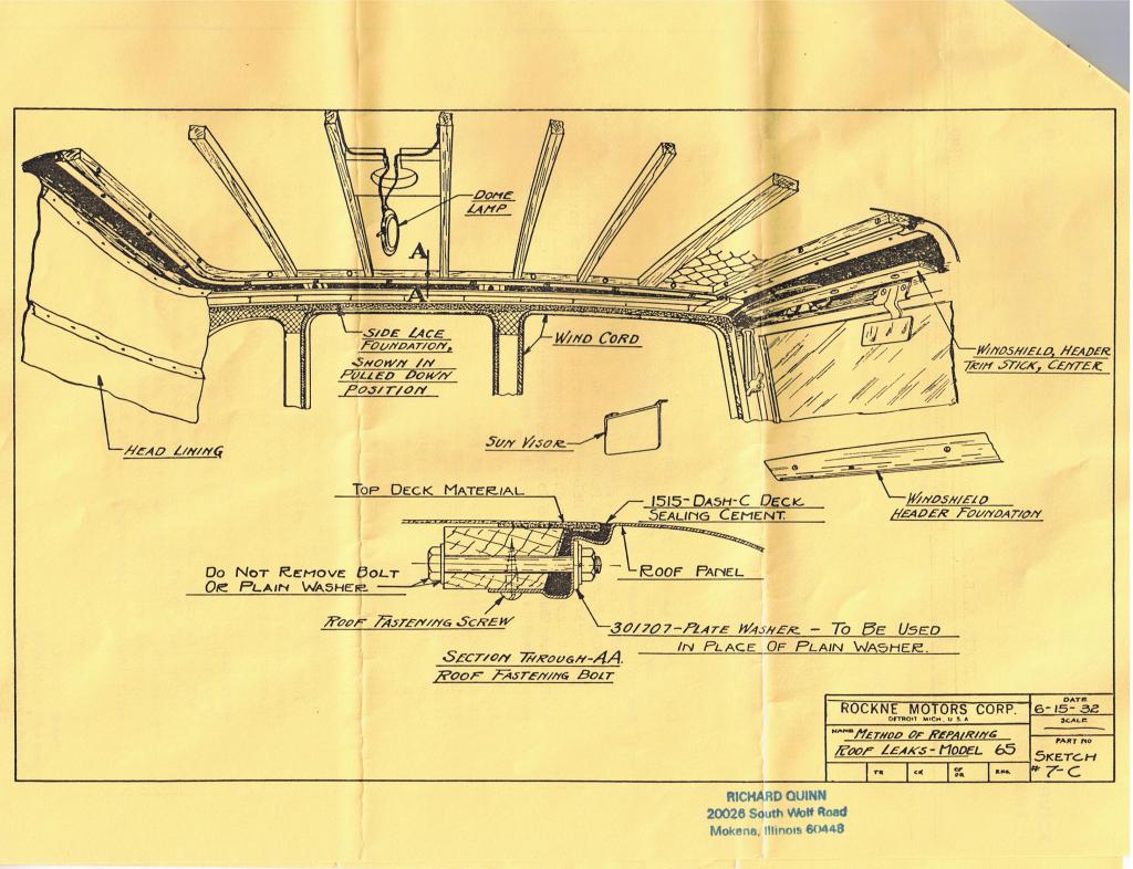

    Rich, do you have this? Click image for larger version
