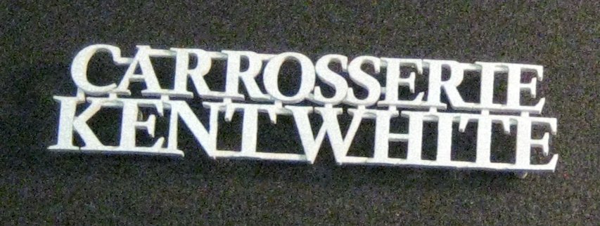

                If you make a CAD file, Shapeways can print it out in several types of plastic or they can laser sinter stainless steel powder and infuse it with copper. You could just polish the stainless/copper part or get it chrome plated. I did have Shapeways make a fun script for Kent White at Tinmantech using a nylon/aluminum powder mixture. It polished up pretty well to look almost like metal, but not good enough to actually use on a car. The edges were a little rougher surface and not easy to polish. Shapeways can tumble parts in corn grit or other media to polish parts but it tends to round off sharp edges and corners a little. The Shapeways web site says they can also print a wax part, investment cast it in brass, and polish it for you, but the maximum length of a brass part made that way is only about 4". The stainless/copper parts can be much larger.
