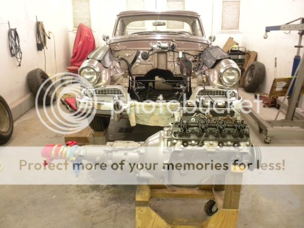

    Well, the first step is complete. The engine is out and we didn't scratch or damage anything along he way. Now I just have to clean up all the pieces and get them ready to install on the new engine when it arrives.
    We pulled a main and rod cap. The bearings were in rough shape and the crank had some pretty good or bad groves in it. There was a grey / black muck in the bottom of the oil pan, in the oil filter and throughout the engine. I am assuming this stuff is the worn away bearing crankshaft material.

        Nothing exciting going back in. Jack Vines is building me stock 259 full flow long block. This car will be a cruiser, not a hot rod. I wanted the smoothest running engine I could get, and my research tells me that is a 259. Since I was getting a new engine anyway, I decided to go to a full flow block. The engine that failed had an R1 cam in it, and it was never as smooth as I wanted it to be. Hopefully this one will be better.
        I think the 259, T86-OD and 3.31 rear will make for a nice driving car.

                      Its not Christmas in July, but its Christmas in August this year. New engine arrived from Jack on Monday.
                      Now the rush is on to get the car back together for our local Labor Day weekend car show.
                      Engine is painted and back in the car.
                      Should be able to participate in IDYSD for the first time this year.

                          Nice looking Engine, no offence to you or my buddy Jack, but that New Engine looks more Tan than Aluminum Silver!
                          Maybe it's the Primer.
                          Do not forget to Dial Indicate that Clutch Housing to the Crank Centerline of the replacement Engine.
