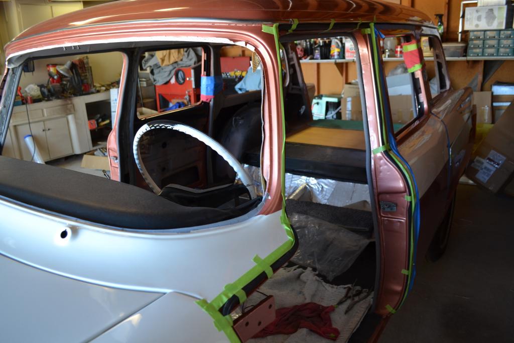

              Hi Jeffry,
              My '57 Clipper wagon suffered from the same ailment. Seeing as I had the windshield out my local upholstery guy (who is doing my interior) glued several different density foams together and hand shaped the dash. He then covered it in black vinyl and french stitched the leading edge. I think it looks better than the original. I know I posted pics of it some time back but I can't seem to find them now. PM me your personal email and I'll try to flocate and send them to you.

                      Hi Chip,
                      I know I have better pics somewhere so when I find them, I'll forward to you.Click image for larger version
