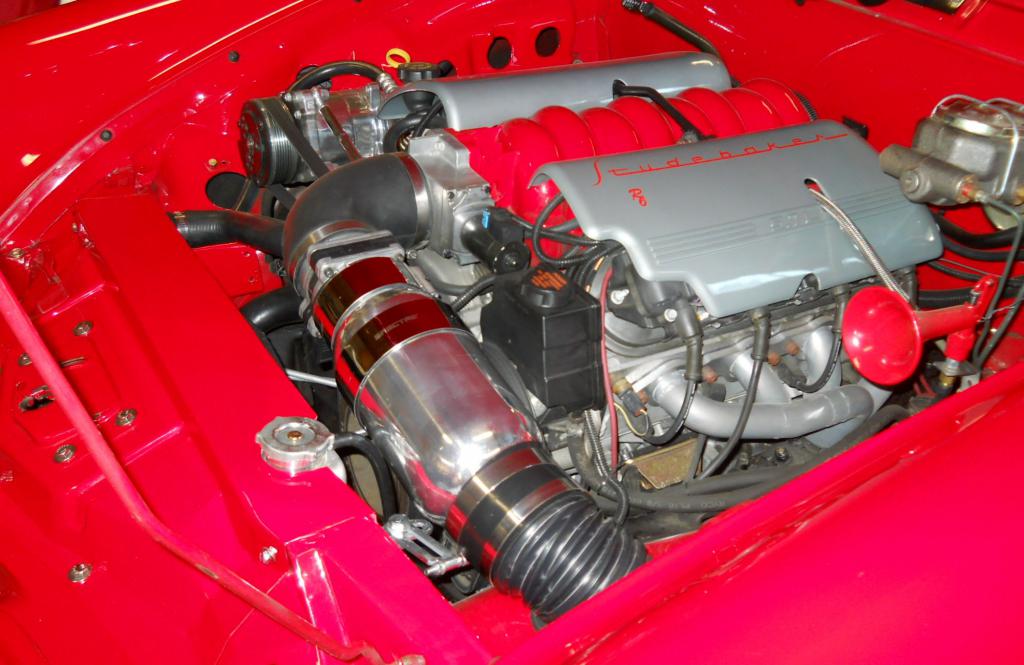

    Barn find, fuel injected Studebaker engine. Well I found it in my barn this morning, anyway. And it does have factory labeling from 1964 on it.
    I removed the raised GTO lettering from GTO fuel rail covers, and installed Studebaker script from 1964.

              Looks good Gene, anything special above the std GTO (errr!! Stude GT) setup? Even if stock that a durn stout engine. Bob
                Why not put Pontiac script on it? Ain't it a Pontiac motor? cheers jimmijim
                            Only change so far is LS7 exhaust manifolds/headers with chambered exhaust side pipes. Also LS7 air filter assembly in front of the radiator. This is a LS1 from a WS6, the GTO fuel rail covers I bought on the LS1tech forum. They are unique to 2004, the GTO's went to LS2 in 2005 with a similar cover, but mounts differently and corresponds to the later intake.
                            As far as your discussion of the 1965 Thunderbolt valve covers, we debated designing a vinyl decal with that name instead of the Studebaker script, as well as "346" instead of "283".
