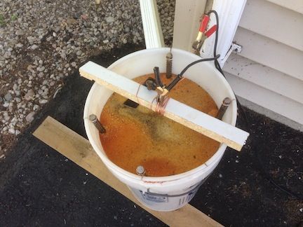

    Over the years I've read all the threads about those that are using an electrolysis bucket/tank to remove rust from parts and always meant to try it. Well, I finally made one to clean up a rusty window regulator and a pair of door hinges. I got my soda ash from a pool supply store and stole a tall 7 gallon bucket from my neighbor. 4 rebar rods, some copper wire and an old battery charger and I was in business. I used the 2 amp setting and just let 'er do its thing for two days (regulator) and another couple days for the hinges. IT WORKS! Removed every speck of rust from the items. All I had to do was brush 'em off, rinse 'em and rattle can a coat of paint...just like you guys said. Really easy AND CHEAP!

        Just another trick. I used a piece of new brakeline across the top of the bucket for one electrode, hung everything from wire hooks.
