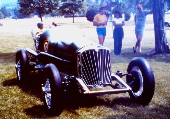

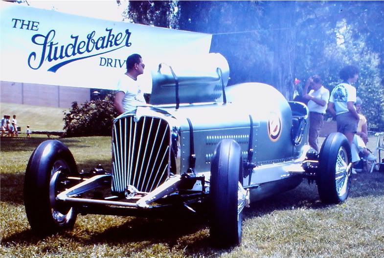

    Stan Smith, Sr and Stan Smith, Jr restored the #37 back in the late '70's early '80's. Their goal at the time was to do a perfect restoration as it appeared in 1931. Remember, #37 was the 1931 prototype produced by Studebaker engineers without corporate auspices. The company got on board after #37 was showing well when it went over the wall at Indy and later won the Pikes Peak Hill Climb. Corporate authorized four more cars to make an Indy team for 1932. Valpey's car is truly "ONE OF A KIND"!
    Here's its restored debut in Boalsburg, PA, 1981.
