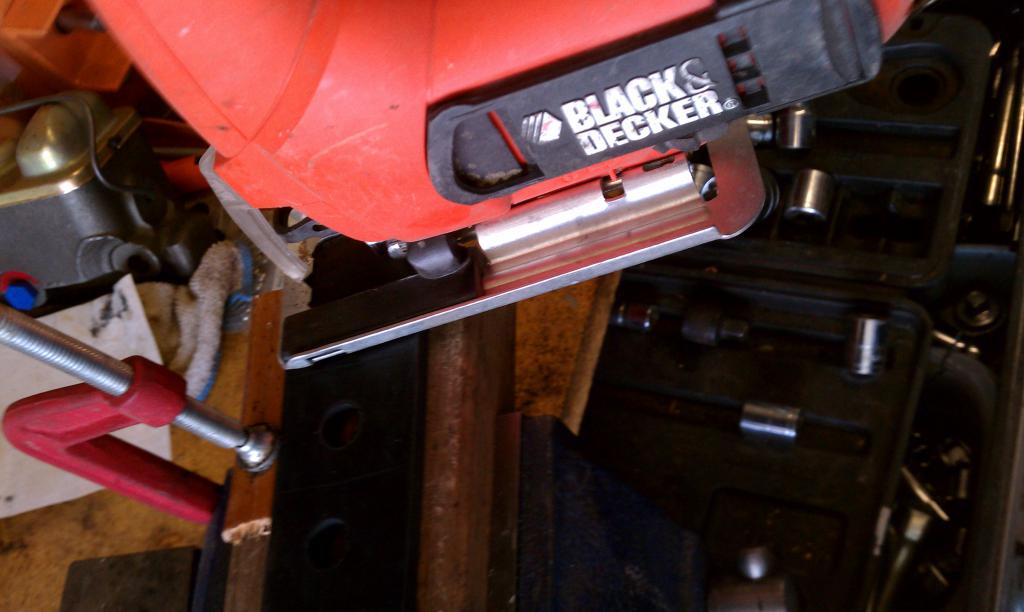

    Just squeezed another nickle out of the budget !
    Grainger has 1/4" X 36" X2" Neoprene for $8.50 a strip. The Speedster has 22 frame to body mounts that were padded with 1/4" conveyor belt. SI sells replacement 1 1/2" X 2" X 1/4" Neoprene pads for $2.50 each.

    Used spade drill with outside cutting points in drill press and fine tooth metal blade in jig saw.

    Thanks for the info! I'm starting on my '64 GT next week. I think the '64's used an additional spacer in the rear trunk mounts.
    Rob in PA.
      The Speedster has a 1/4" steel and a 1/4" rubber pad at each mount... I'd expect most models are similar.
        No surprise on the SI pricing.... Tractor Supply has the strips too and in various sizes.
