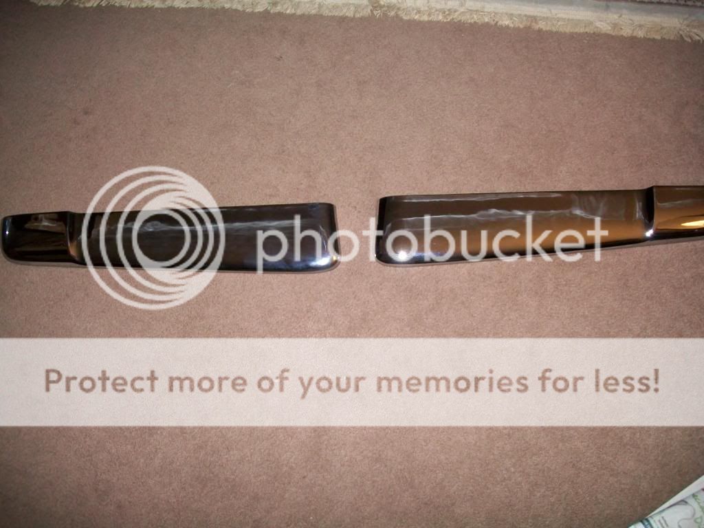

    When I got my '53 prototype almost two years ago it was missing two vital styling parts, the grille bars. I knew why they were missing, but that's another story... I had just about called them a loss to the car and decided that if I ever got far enough bringing the car back to life that I would just use production '53 grille bars which are slightly different from the prototype ones. Well, this past week I think it's safe to say a miracle happened. Thanks to Matt Burnette, Chuck Kenney, and Brad Kuchan the grille bars were found, bought, and are now back with the car that they were made for... Just kept in a locked room for safe keeping. Along the way the grille bars got chrome plated which they wouldn't have been originally (originally they would have been wrapped in foil to simulate chrome) but they sure do look great. The photo is of the prototype grille bars. Notice that unlike production grille bars they lack turn signals and do not say "Studebaker" "Commander". They are also solid cast aluminum and machined out on the underside to make them lighter; unlike production ones that were die-cast and probably weight less than 1/4 of what one of these do. These also mount the car differently. I have to look at the prototype's front fenders but there are five bolt holes on the bottom of each bar. That's basically reinforced compared to a stock grille. Anyway, these things finally came home.

              Did the prototype have parking lights/turn signals?
              If so, where and what configuration?

                      Bob Bourke was not pleased with being required to place the "Studebaker" and "Commander"/"Champion"/"Land Cruiser" nameplates on his parking light assemblies (grille bars).
                      Have you checked the Bob Bourke personal files at the SNM for information/drawings of the car/prototype? Bob kept most of his work (that later went to the SNM).
                        Interesting that the seller was promoting them to install in a '53 or '54, but they are WAY too short to do that.

                            Good question, I'm not really sure. As you noticed, the prototype grille bars lack turn signals. Since the complete prototype was never actually driven on public road I doubt that turn signals were ever installed. (At leas on the front) That's one of those things that I will worry about later. I can always hide a couple lights under the grille bars out of sight and out of mind until they are needed.
