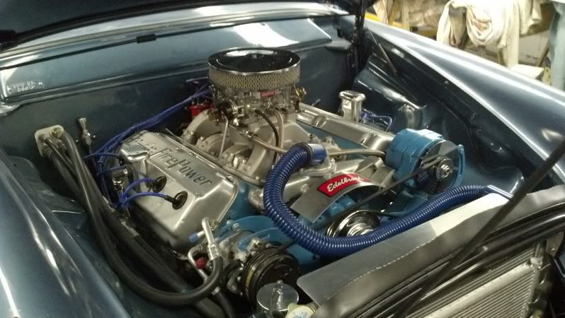

    I drove to the other side of Atlanta today to an SDCer's house, to pick up the stainless for a '62 Hawk he is getting ready to repaint. He restored the car about 30 years ago, and it was showing its age. Rather than rebuild the tired stock drivetrain.. He opted for a '58 392 Hemi. No real surprise.. Another Stude he built and sold not long ago was a '47 M5 with a 472 Cadillac. Matt in Australia bought the M5, and he asked me to show Matt the pics of his Hawk.. Enjoy!
    Stock frame and suspension with rack and pinion steering.

            I like it. but their front heavy with a 289 I wonder what weight that big hemi puts on the front end. Great for showing up the young motor heads at a burn out contest though.
              This car goes to show You how big that C/K engine compartment really is! I'd love to drive this thing!
                I of course haven't driven it, but Fred says it goes down the road without any issues. Well, except for the 8 MPG.
                  Depending on whose published weight chart one believes, the '57-58 Chrysler 392" hemi is from 25-75# heavier than a Studebaker V8. (The problem with those weight charts is they are pulled from a variety of older sources and it's unclear how each engine is dressed. Is it including accessories? Including clutch, flywheel and bellhousing? Ready to run? This chart http://fixrambler.com/engineweightchart.txt has the Studebaker V8 at 650#. I know from personal experience that would be without accessories and clutch/bellhousing. This same chart has the '55 hemi at 725#.)

                        I love old hemis but I love a balanced car more!

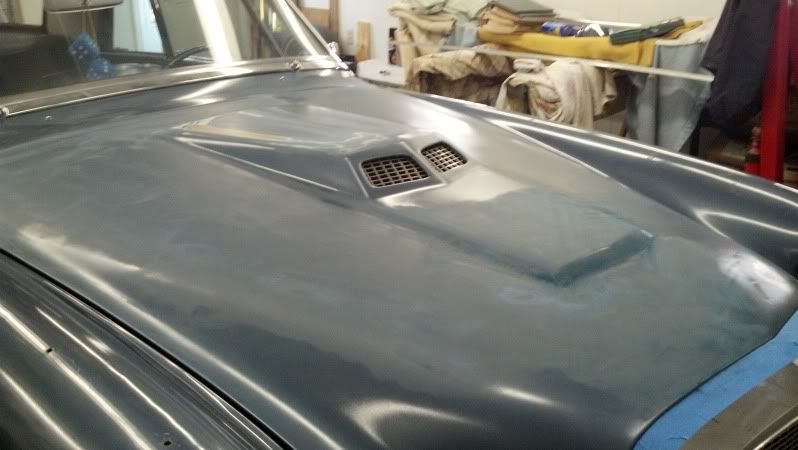

                          I installed a '58 392" Chrysler Imperial Hemi and cast-iron Torqueflite into a '58 Studebaker Silver Hawk. Not really practical for the street, but I did use it as an everyday driver. Had to scoop the hood as on this
                          GT Hawk. VERY heavy engine, Certainly much heavier than the Stude V8.....and I would guess at least several pounds heavier than the Packard V8. Considerably wider than the Stude or the Packard.....but that
                          big C/K engine compartment indeed contained it. (I had a custom driveshaft made up, and used the Chrysler mechanical pushbutton setup from the Imperial. Trunk mounted battery. I ended up re-installing
                          a Stude engine after several months, (winter was coming!), and selling the Hemi to a few guys who were building a dragster.
                            GT Hawk. Considerably wider than the Stude or the Packard.....but that
                            big C/K engine compartment indeed contained it. .
