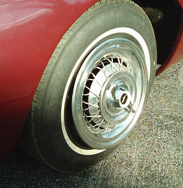

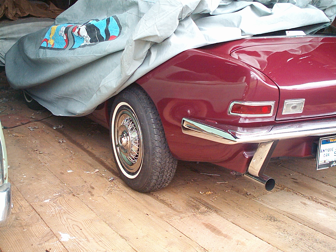

        While the cover is made up of several components, they are one-piece in application. Other than being able to unbolt the center spinner you don't want to try to take one apart. I'll try to find my very old post showing installation steps. If I don't find it, I will re-post the pictures.
        Found the pictures

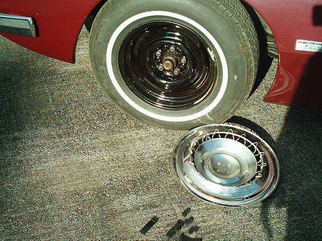

        I couldn't find enough original Studebaker clips so I bought some from a Thunderbird supplier. They were much poorer quality (Stude clip on the left, Ford on the right)
        Stude clip below, Ford above
        Getting ready to tap the clips on the wheel
        Two Ford clips installed

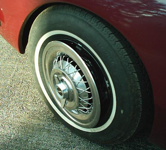

        Clips in place and cover snapped in- pulled out for illustration
        Pulled out, another angle. Note-there is no hole for a valve stem. You have to pull out the cover to check the tire (very short valve stem required)
        Another view
        Snapped in place
        On the car
        On the car
