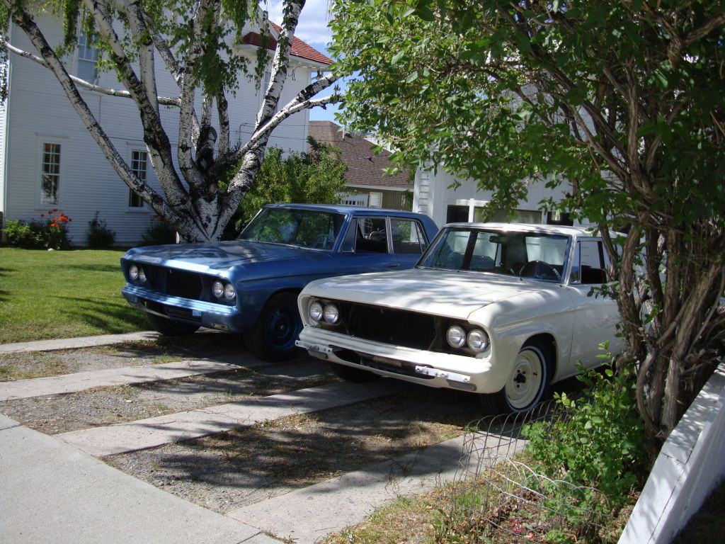

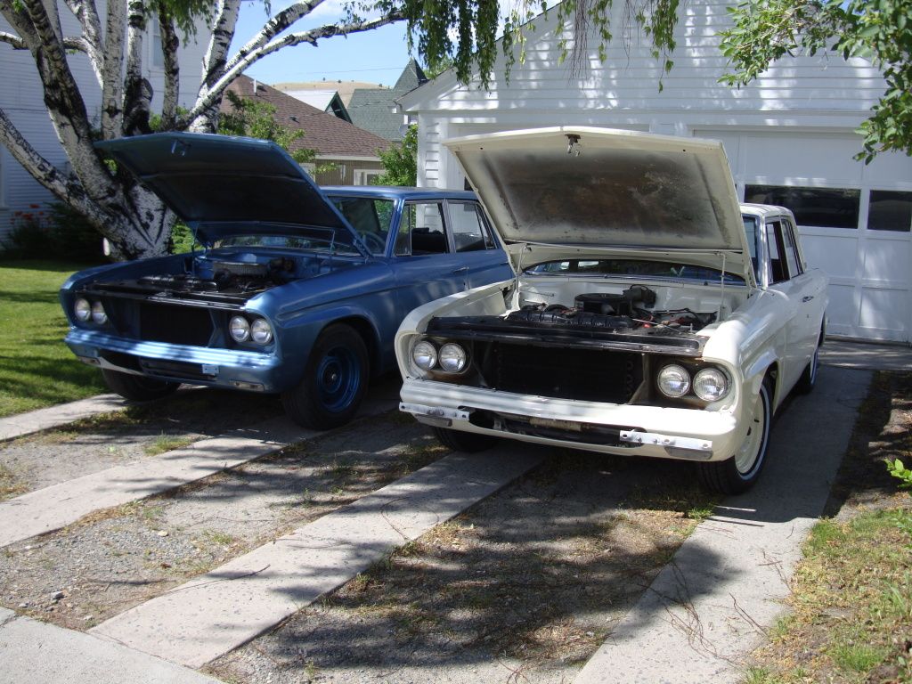

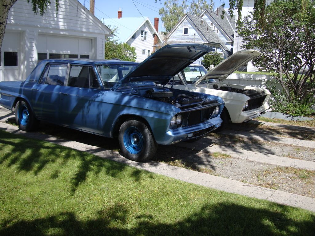

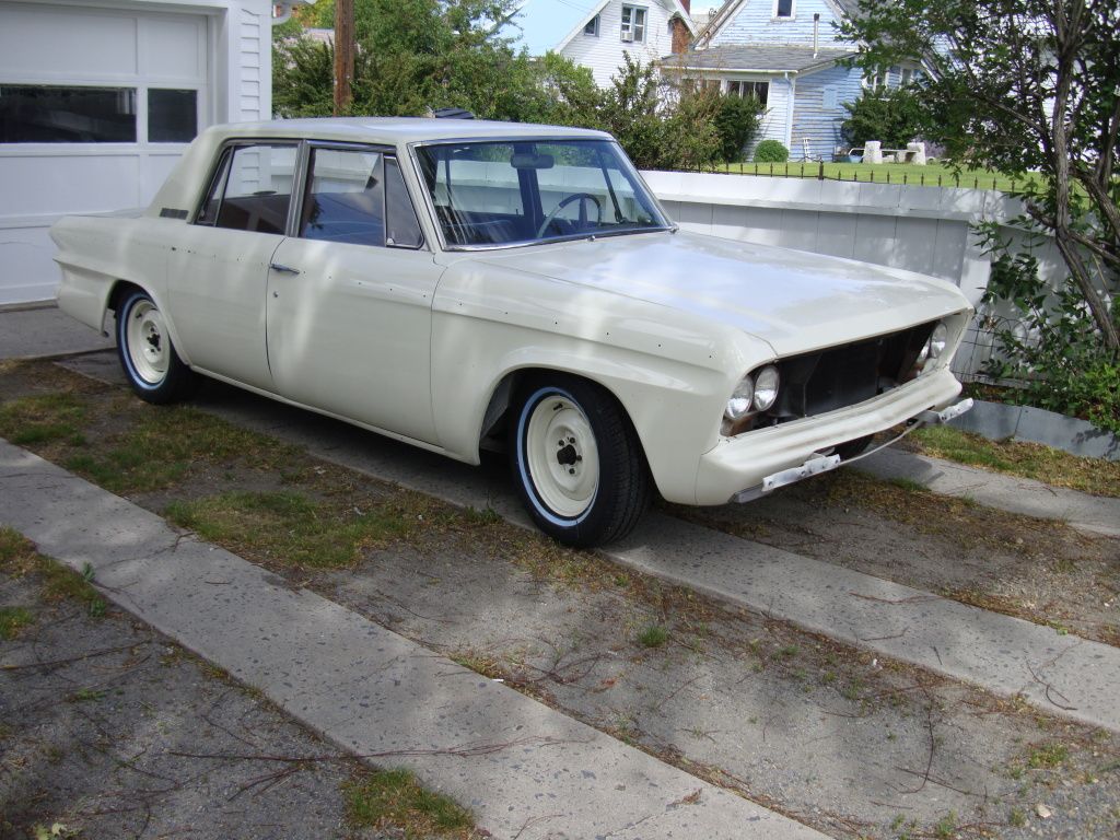

    Here are photos of my two Cruisers after paint but before I got the bumpers on. The blue one is out for new upholstery or I would have a more recent photo. They are both good drivers and now there is room for both in my garage. See previous post of R-2 Avanti sold. Can you tell which is the "65? They both will have the correct color wheels.

    The white one is the 64, the other the 65.

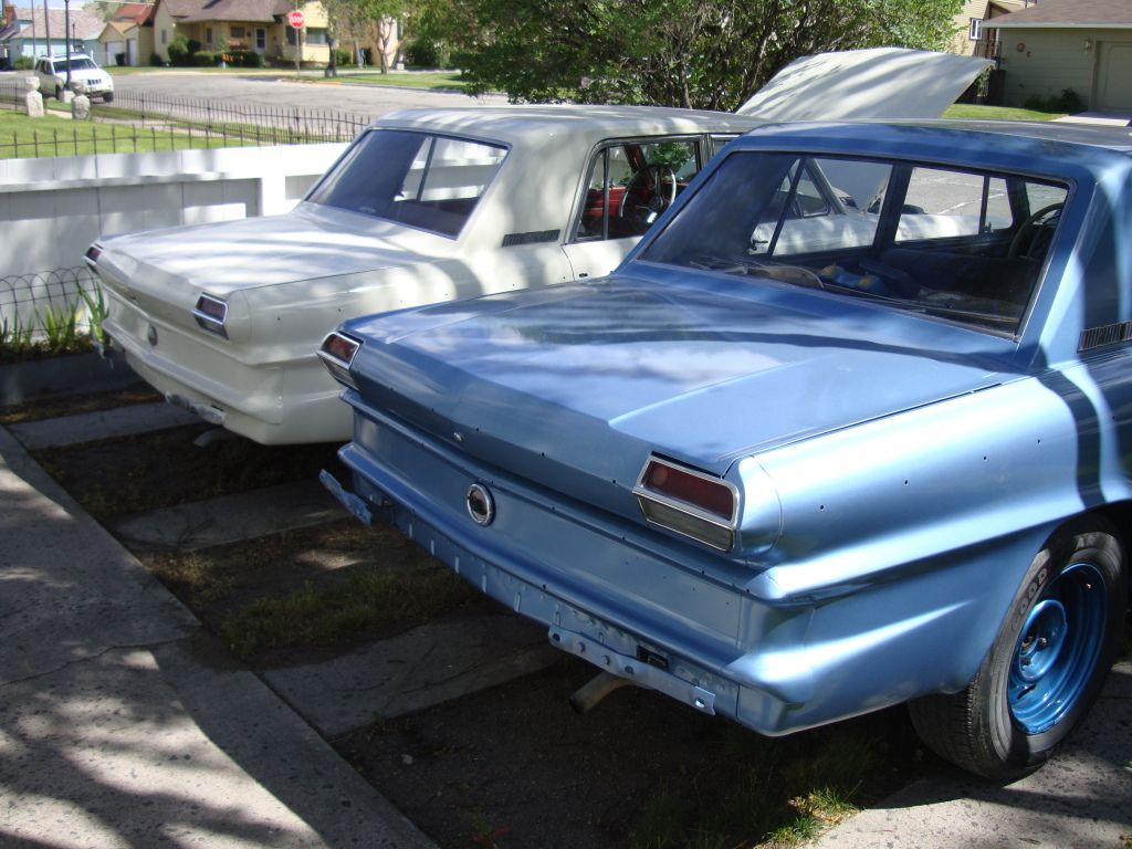

      Looks like you have two nice book ends,though I notice there are no full size mouldings on the trunk lids.

        I am just guessing, but it appears in your pics that you left the Cruiser only chrome molding located at base of the "C" pillars on during painting? If so, is it difficult to remove? I am curious because when I go to paint our Cruiser that would be good info to know.

              Yes, it was too difficult for me to remove. Another real problem is putting in new cat whiskers (outer window run felt strips) using the window run clips 32235x1 recommended for these cars without removing the windows. I resorted to using silicon sealer to complete the job. No problem on inner strips if you remove the door panels, although I decided not to replace them as they were not as badly worn and weathered.

                The supposed to be, Laguna Blue Car is a '65 and they only have the small center Deck Lid Moulding.
                I can't see if the Chevy White Car has the holes for the Daytona Mouldings, the '64 Cruiser Mouldings or the '65 Cruiser Moulding or none.
                Nice Paint jobs Jack, how did you get the Engine compartments done without pulling the Engines?

                  As has been pointed out, the blue one is the '65 due to the McKinnon engine, Hamilton-Style Body Tag, and Canadian spelling of the word Colour on the paint label, among other things.

                    The white '64 has the full size aluminum molding for the trunk lid which says "STUDEBAKER" in 2 inch raised chrome letters. Blue '65 has narrow aluminum trim and has "Studebaker" and "Cruiser" in separate script pieces. They will all be put back on the car when I get them adequately polished, which I am doing myself. I can't see sending them out for "professional" restoration to "like new" as it is too expensive relative to the value of the car. Same goes for the bumpers, which have been straightened and polished as best as I can do. I just got the front center bar from the '64 Avanti re-chromed in California for $300. Imagine what it would cost for the bumpers and bumper guards on a Cruiser. Costs have gotten out of hand. I still go back to the philosophy of Bob Palma's little book titled something like "Shade tree mechanic's guide to Studebaker repairs", or something like that, which I wish I still had. I am preserving Studebakers, not restoring them to "like new" condition. That can be done with those with, as my dad used to say, "more money than brains."

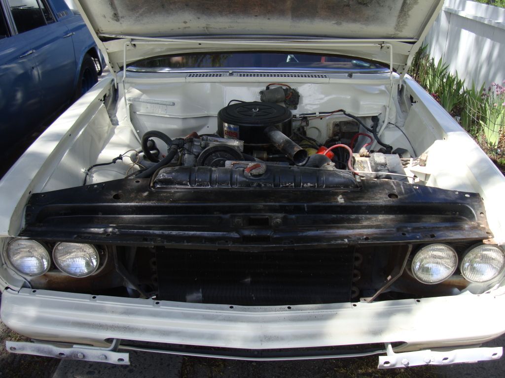

                      A couple of comments, Rich. "supposed to be" refers to the paint color, which I did my best to match, looking up multiple "original" paint formulas and chips. The engine compartment on the "supposed to be, Laguna Blue Car" was probably done before the engine was put [back] in, after who knows what was done to it. It runs great, like any GMC engine of that era. The exterior paint was done with our best efforts to match the color of the door jams, which are factory original and probably faded a bit. The end result looks just about like the color of the Laguna Blue Cruisers I found on the internet. I did have the upper part of the cowl facing the engine and sides of the engine compartment repainted, although they looked pretty good to begin with. Also a great match to the lower part of the cowl. The car as I got it must have been repainted in Laguna Blue, as the color was the same but oxidized.
                      Similar for the "Chevy White Car", where I had the trunk lid off as its exterior needed to be sanded down to bare metal as it was badly cracked by an "Earl Shibe-type repaint", and the whole exterior was what could be considered "Artic White", which did not match the color of the lower part of the cowl facing the engine or the door jams and interior of the trunk and trunk lid, which more corresponded to "Parchment White", which is more of a cream-color, or "Chevy White" as you refer to it. But the new exterior color is an excellent match to the lower cowl and door jams and interior trunk lid, which were not repainted. "Parchment White" is listed as a Studebaker truck color for that year and others, and may have be a special order at the factory. There was no factory paint tag that I could find. =I have guy who is a great painter. One stage Nason Ful-Cryl Acrylic Enamel was used on both cars. For the white one, Spectramaster Color Atlas white code CAS991. More than anyone wanted to know. Thanks for the compliment!
