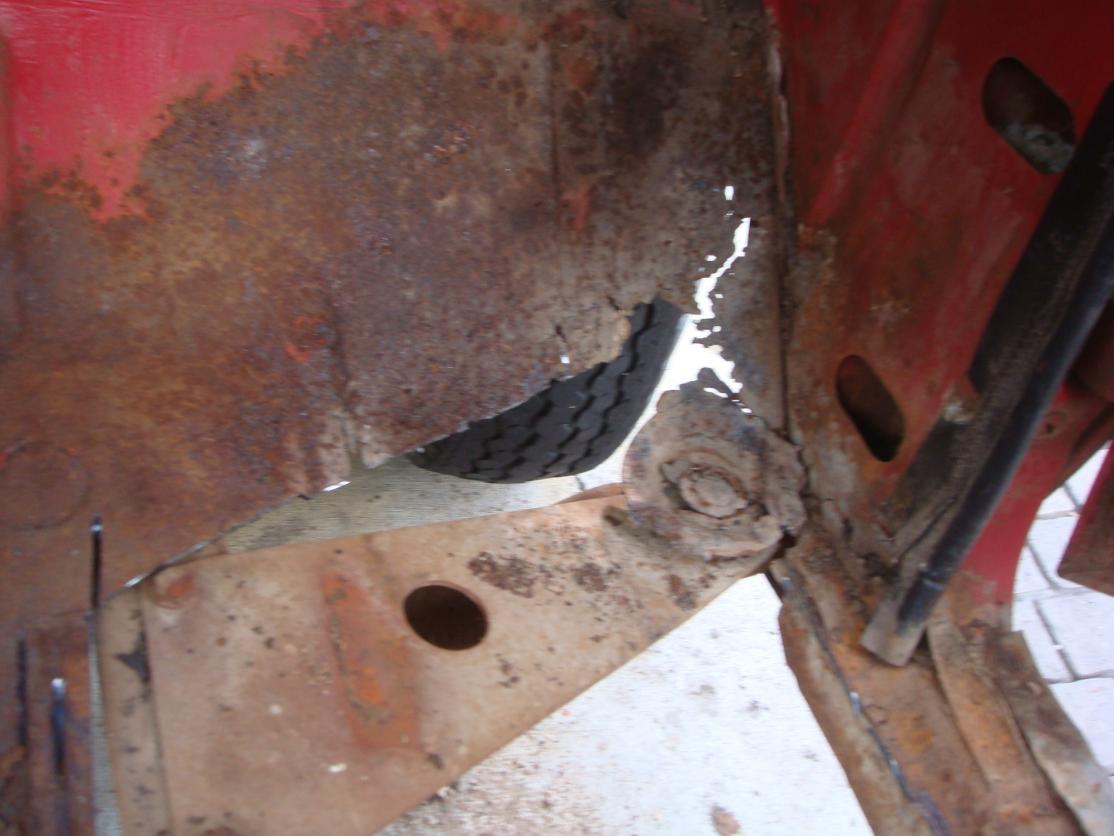

      I have to periodically go back and remind myself where we came from-----
