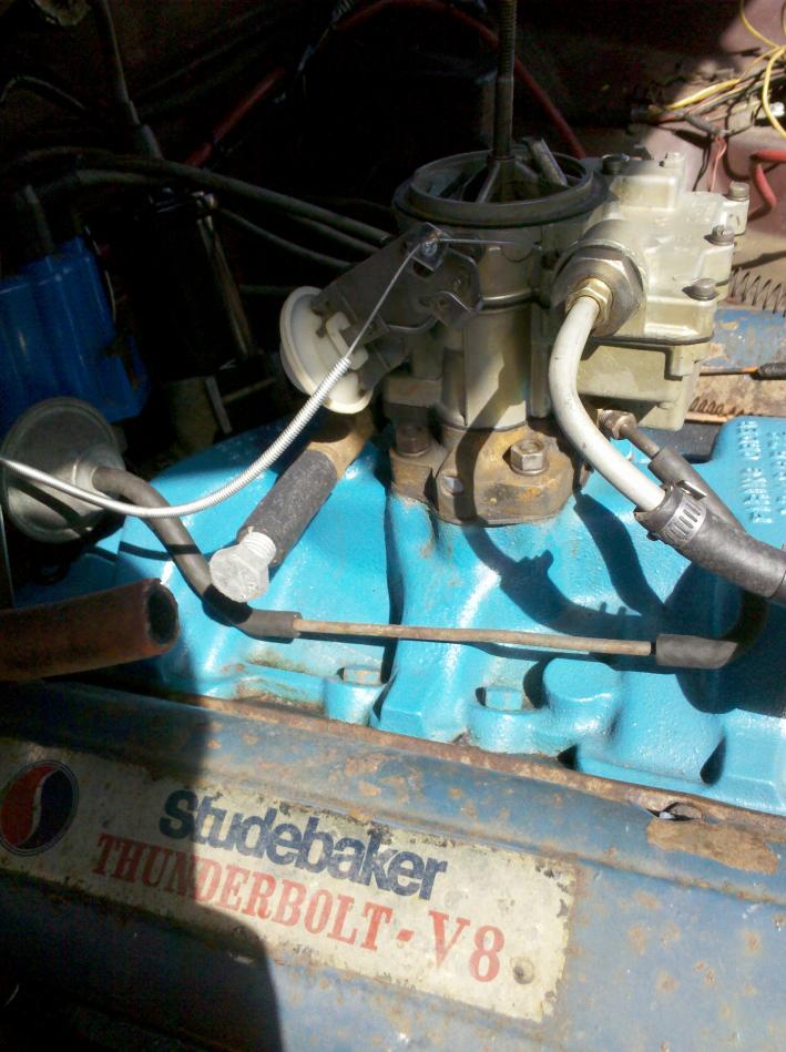

                      Attached are a few more pictures of my set up that I was able to snag on Sunday.
                      There was no inlet on the air cleaner unit for this hose to plug in to. Could it possibly plug into the blocked carb unit?
                      1960 Lark VIII Regal Wagon
                        Yes...that is a hose on the port that is on the rear of the block on early SBC's. The only ones I have seen go to the base of the air cleaner to provide make up air for the PVC valve. The PVC valve is generally on a hose going from the oil fill tube (or directly on the oil fill tube) to the intake manifold.
                        It is possible that there is a closed CCV system that has a pvc valve in the hose you show that would then connect to the intake or base of the carb. Then the make up air could be drawn in through a vented oil fill cap.
                        Can you provide a picture of the oil fill tube?

                          Is this the pic that you wanted to see?
                            Yep.
                            That's a vented oil fill cap and there is no fitting on the oil fill tube for a PCV valve or a hose...therefore, the hose in this picture...
                            ...should go to a vacuum source with a PCV valve installed prior to the vacuum source.
                            You'll probably find a pipe plug somewhere in the intake manifold or the base of the carb you can use as the vacuum source. Either use a PCV valve that will screw directly into the manifold/carb base with a hose barb on the other end and attach the loose hose to it, or put a fitting into the manifold/carb base with a hose barb on the other end and use a PCV valve with hose barbs on both ends IN the hose.
                            The PCV valve is a one way valve. If you suck on one end, you can draw air. Suck on the other end and you can't. Make sure the PCV valve is installed so that air will flow TOWARDS the intake manifold...in other words, when the engine is under light load and producing vacuum, crankcase vapors will be drawn into the engine and burned. Air to replace the crank case vapors will be drawn into the crank case via the vented oil fill cap.
                            You will most likely have to readjust your idle speed and mixture.
                            Dick Steinkamp
                            Bellingham, WA
                              Do you think that it may have originally gone to the port in this picture? The one with the bolt attached to the black hose? It appears that it is part of the base of the carb.
