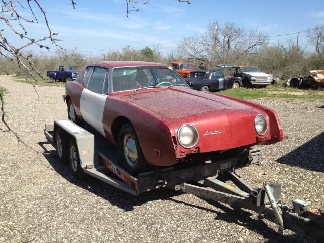

    My Grandson and I traveled 90 miles to San Antonio to meet a Transport Truck and get the white door Avanti I bought from Florida last month. Peg was having a problem with getting door to door delivery, so I agreed to pick it up in San Antonio to speed up delivery. The transport truck had some delays, so it was 11:40 pm when we met at a truck stop. The Avanti turned out to be inoperable so it was a chore unloading and reloading it. The driver spoke little english but enough to say it needed gas as the guage showed empty. I added some fuel and used starting fuiid to start it . It ran poorly even after running the motor for several minutes, Not enough power to back over the center hump of the tranport trailer. There were two cars behind it that were unloaded first. the one behind the Avamti was a new Yellow Porsche that had only about 2 inches between it and the rear bumper of the Avanti and had to be backed up hill away from it to be unloaded. All I can say is the transport guy was an excellent driver. He and his traveling friend stayed and helped us load the Ananti on the trailer. We got back to Uvalde at 3:30 am. It was a nice full moon night. I backed it off the trailer Sarurday afternnon and took the Transport Trailer back to Uhaul ($72.00 for use). Before I went to bed I was thinking about why the engine on the Avanti ran so poorly and rough. Then I remembered that I did not even check to see if there was any oil in the engine and we had ran it for a while. I checked it this afternoon after my wife and I got back from our Christian Meeting. And sure enough JDP had put oil in the motor after he rebuilt it! It appears it hasn't been ran hardly at all sense he sold it back in September 2004. His 10 year 100,000 mile warranty should still be in effect. I unloaded all the goodies from the trunk yesterday but haven't started getting the things out that are packed inside the car. The new windshield washer fluid bag under the hood looks nice.

        The seller said the carburetor had been rebuilt, but it appeared to be running very rich. It has the R3 airbox so I didn't take off the cover to see if it was flooding. I will change the plugs, check the firing order, redo the carb, and check the timing. The weather has been very cold here in Texas. 32 degrees this am! I have about a dozen Studebakers. 3 are Lark parts cars.
