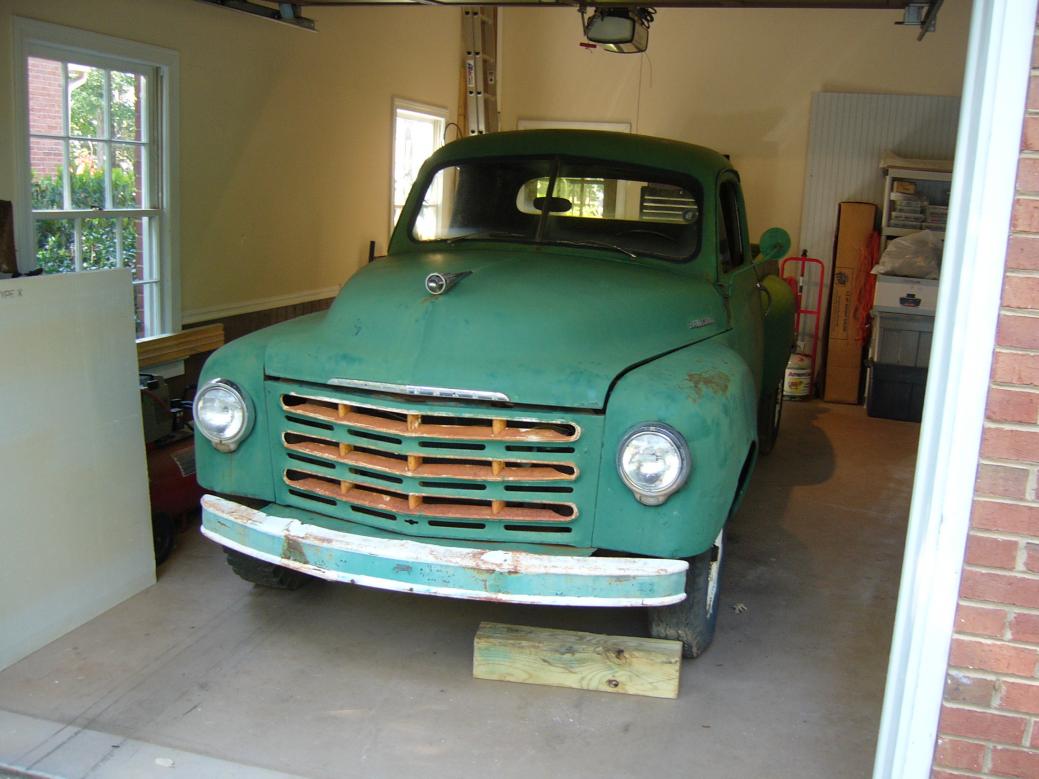

                      Thanks for all the comments, guys. I'll post some pix tonight or tomorrow.

                        ]Bob, thanks for the tip on the spell check. Now all I have to do if figure out how to post the pix...

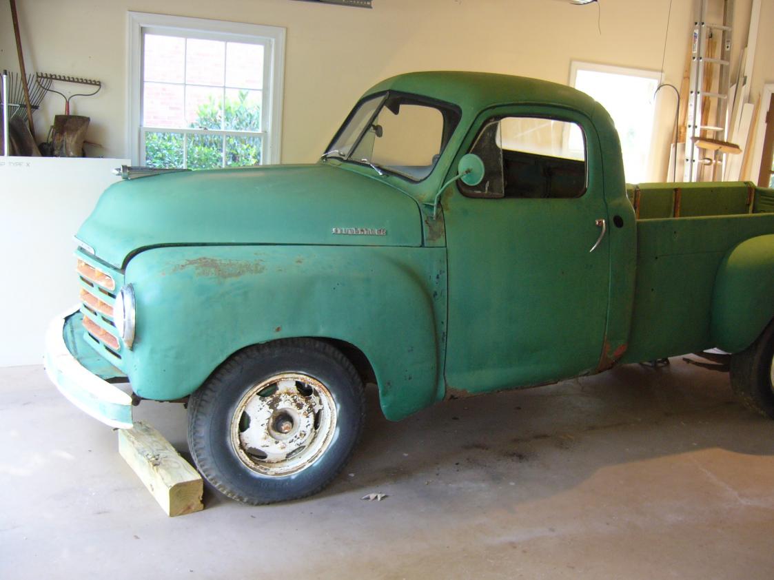

                          Looks like you got it figured out! Nice find. That truck looks like what I like to call a "Warrior." The battle scars earned doing what trucks are supposed to do.
                          According to google maps, you are only 135 miles from me. Hope to meet you some day.
                            Bill looking good. Thanks for the pics. John C called it right, that is a warrior from back in the day. I love it.
                            Are you planning on a restoration, or just getting it safe and driveable and keep it a work horse?
                            Mine is going somewhere in the middle, half ranch truck work horse and half hot rod ish.....
                            Keep us posted on your progress.
                              Thanks for the pics. Nice truck. Looks right at home in the garage. Some day I'd like to find a smaller Stude truck to run around in. Going to be a fun project.
