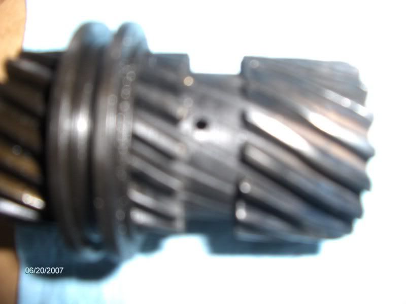

        Got started on the trans. around Noon as planned. About 12:30 Biggs, Guido, and Dick Steinkamp started peer-pressuring us to take a break and come meet up with them for an impromptu MGE (meet, greet, and eat). But Doc Garbareno and Gord Richmond were into the process, and we pushed on: Gord and Doc, along with recruiting Tom Bredehoft and Phil Hendrickson. They did the work; I cleaned parts and videotaped, and tried to stay out of the way[)] Over the next 4 hours or so, lots of folks came by and watched parts of the process.
        Turns out the planetary cluster was totally trashed[xx(] This was caused by running without gear oil[:I] Now I know: when you check gear oil level, you check the trans. proper, AND ALSO the O/D unit!
        Doc and Gord had brought plenty of parts, and had everything needed to get it back together correctly; filled it with oil and Gord took it, me, and my nephew Evyn (VERY patient future Stude nerd![^]) out to the lot where Molly sat looking forlorn on the tow dolly.
        As he had done all day, Gord fearlessly scrambled under taking pity on me and Molly, and in less than an hour we popped the freshly rebuilt trans. in, buttoned it up, and test-drove it; SUCCESS!! I drove it, Gord took her for a spin, then a group of us celebrated by raiding my cooler for various refreshments Had fun talking Studes with Gord, Doc, and Rich, Mike, and Dave from Studebakers Northwest (in whose area we did the rebuild). From there it was on to get Mexican food (complete with musical dinners) and more Studebaker talk[^]
