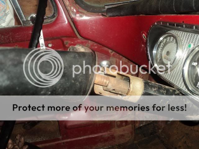

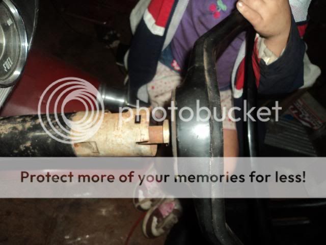

    I need a upper steering support for a 60 lark.is that sort of thing available anymore?
    this is what I got I was told this is the spot to ask,let me know what and how much.thanks

      What you should be looking for is a 1692500P Housing and bearing. 1692741 Bolt, to jacket 1/4" x 28 special, 3091X4 Nut and G120386 Washer.

              in the top pix, what are the pieces missing in the corners of the dash pad called? and are they available to the public?

                Just from those pics. it appears there may be several more parts missing, and not just the "support" itself. There is a good chance Studebaker International may have all the component parts needed, but if you'd consider going with a completely assembled "used" column, try giving Tommy K. a call
                (574) 287.5834. Before calling Tommy, make sure you have the model year and know automatic or 3 spd.
                PS: Tommy also has the best inventory of used Lark steering wheels in really great condition that I've ever seen.

                    That would be a trim piece......I would call it an A pillar/dash cover piece, covers the ends of the padded dash, and the pillar itself.
                    I would guess an easy, post on the forum and ask for one......item, (left and right), or swap meet find.
                    Book calls them, Cowl Top and Windshield Opening Panels.
