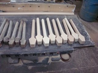

    Checking out the spokes, most required new ones to be strong and true:
    New Spokes were made and installed:
