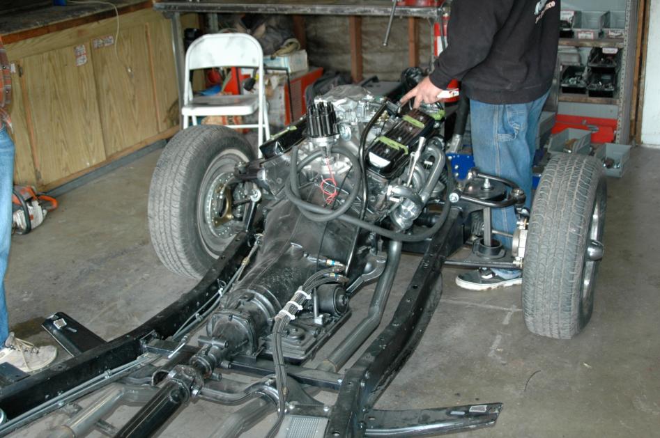

    Getting ready to fire her up!

    1954 C5 Hamilton car.
      It taken a long time to get to this point. Body is going back on for the last time this week.

          What did you use for the front suspension conversion? Fatman, etc.?
          Please post how it handles when you get the body on, I'm interested.

            I will let you know how it handles. Mustang II IFS frame stub and a FatMan front clip specific for a '54 Stude.
              Beautiful! Very interested in how that clip works! I'd like to do that to my Super Lark clone. Would love any more info and pics you might have. Thanks for sharing!
              What rear suspension and axle are you using?

                Whats up with the backwards thermostat housing?

                    New leaf springs from Eaton, otherwise orig Stude rear end. Lots of pics, just not sure how to organize offer them and get them out there.

                        Please tell us more about your rear springs. And have you picked a radiator yet?

                          I see you have a stepped diameter driveshaft to help clear the tight tunnel. Was it made up new or is it from some other vehicle?

                            Very nicely done, I love your attention to detail. I am considering a Fatman front end for my 54 Conestoga. I understand they make them so sheetmetal pretty much bolts in place. Would be great to see pictures posted on someplace like Photobucket or Flickr.com.
