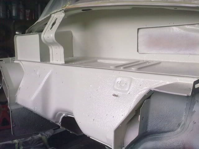

    on the firewall.
    All pictures Ive seen on restored, C-cabs shows black firewall.
    But this stock C-cab has body color firewall.
    My Transtar -57 had a black (messy) firewall.
    Now, my firewall is cleaned up, and painted Artic White (upper body color)
    The best noise reducer I found in Sweden is gray/tan.
    I will spray it on the firewall.
    Should I then paint the firewall black?
    Or Artic White again,
    Or, should I paint it Apache Red? (lower body color)
    Or, let the firewall be gray/tan?
    How was it colored from factory?
    Thanks.
    Lennart...

                I will use the "Damping compound DC-P 500" on the firewall.
                I also will spray it inside the roof, and behind the seat. It will isolate the cab from heat, and reduce noise. It is cheaper than the dynamat/liner.
                It is tan/beige, but I can mix it white (or black), or paint it when it is sprayed on the firewall.
                This is not an undercoat, I will use it to get a quiter truck.
                Lennart...

                  The dash is finished. I have 5 thin layer of "noise killer" at bouth side of the dash, then I painted it.
                  Lennart...
