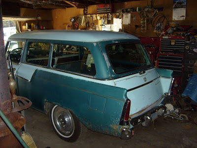

    After over three months of work cleaning and shifting junque, Bess (to quote my son) is in the house! Actually, I pushed her in on Friday. All of this is a month late... however, better late than never, ya-know?
    It's interesting how everything on this motor was the same green as the outside of the car. Her beauty was far more than skin deep. I still have a deal more cleaning to do. Also, there's a few things that have deteriorated over the past year or so. For instance, the exhaust valve is stuck at mid-point. It'll have to be replaced. The carb has gotten really stiff. I'll have to soak it to hopefully free it up. I might just plop the bottom of it into a pan of diesel (George style) and see if that does the job.
    I pulled the oil pan off yesterday and hammered the big dent out of it. Looks really great now. Thankfully, whatever the O.O. hit with it didn't puncture it. I took a good look at everything inside whilst it was off and it all looks really great. Nice and shiny, no excessive wear or play. I still have to scrub fifty-two years of grunge off the rest of the engine. All I can say to this part of the procedure is, YUK![xx(][)]
    All this while still getting the garden going, which is saying a lot around here.

      Sure hope that you are going to pop out those core (soft) plugs and flush out the block? You ain't gonna get any closer than you are now.

          Its always a judgement call what colours an old car is, with faded paint, dirt, inside a garage under less than perfect light, what a digital camera is interpreting as the shades involved under those conditions, and what a computer is doing to all that input, but is Bess supposed to be Glendale Green and Turquoise?

              Your car looks pretty sound from here. I don't envy you the job of cleaning the engine, but someone has to do it.

                You know, I reeeeeally like the Connies too. Bess, however (and I love her too) is a Parkview. The year after ('56).
                LOL, I know what you mean about dirt, grunge and telling what type an engine is! Underneath fifty-two years of grime is a strong 259. The only fly in the ointment with Bess' powerplant is the valve noise. She needs her valves adjusted and I don't know how, nor have the tools, nor have the... bravery.[:I][8)] I believe she might have been Sea Mist and Glendale. She's definately not Turquoise (on top). I think it's the flourescent lighting that's making her look bluish. The colour reproduction on the engine, however, is spot on. Probably because of the natural light.
                I have a picture of a hawk in the same colour scheme and if I can find it, I'll post the picture. Ah, I found the picture. It was provided to me by a kind gentleman who also provided the paint codes. Sadly, I've lost those codes.[)]
                Ed's not jealous because he's getting new brake cylinders here in a week or so, and just might be the one going on the trip to So. Cal. this month. My friend Paula wants to make the trip in Bess. However, that doesn't look very likely as Bess needs a bit before she can be roadworthy again. I'm not sure there's sufficient time to get her done.

                      Looking good Ron.. Wish I was a little bit closer so I could walk you through the valve adjustment. Reading the posts on here about valve adjustment would scare anybody. LOL [:0] Its really easy and only requires a feeler gauge, a wrench, and a couple gaskets. Keep the pics coming with your progress.

                          A valid point. However, right now time is of the essence. Still... that is an idea... if things don't look like I'll be able to make the caravan to La Palma with Bess, I just might do that.
                          I took the old girl's carb apart yesterday. YEESH!! I forgot how complicated those things were.[:0][}] Now, all I have do to is clean it out and get it back together.[8]
