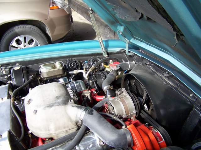

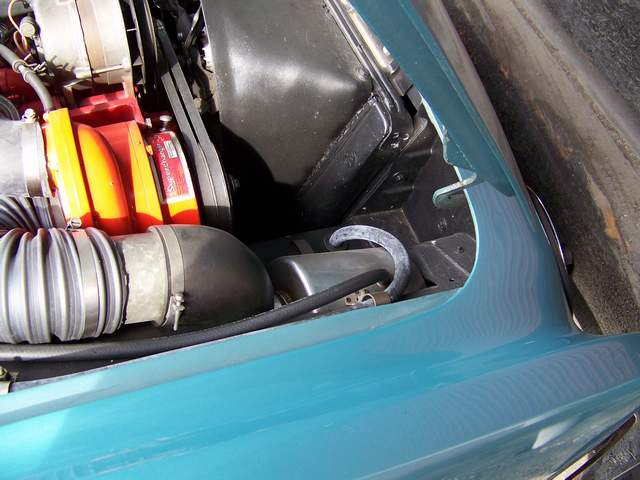

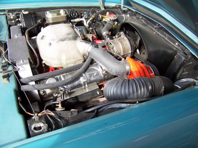

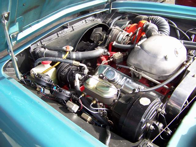

    Tuesday and Wednesday my wife and I made a test run of our Potomac Chapter Spring Tour (from Winchester, VA to Roanoke, VA). At the O. Winston Link Museum in Roanoke we were met by a South West Virginia Chapter member, Willard Hamill. After giving us a brief tour of the Link Museum he told us to be at the Museum a little before 10 am the next morning and he would take us to the Transportation Museum. Wednesday morning he came rumbling up to the Link Museum in a very nice turquoise '63 Avanti. I noticed it had the standard Avanti A/C in the console, but it also had Avanti Supercharged emblems on the front fenders. This is what I found when he opened the hood-
    Needless to say, the battery is in the trunk. It had the regular York compressor until Willard had it replaced with the little Sanden.
    When Willard bought this car it had a 4.27 rear with Powershift. The PO used it for drag racing- claimed to have never lost to a Corvette.

      That looks like one well done, and very full engine compartment! [^]
      I see lots of mods in there, custom air cleaner mounting, R3 Air Box, fuel pressure regulator, Dual Master Cyl., relocated horns, surge tank eliminator fill fitting, coolant overflow system, relocated battery, relocated windshield washer bag, and of course all that special AC equipment.
