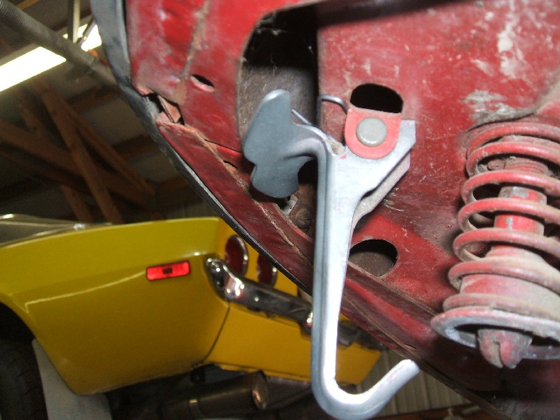

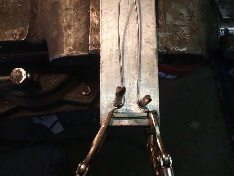

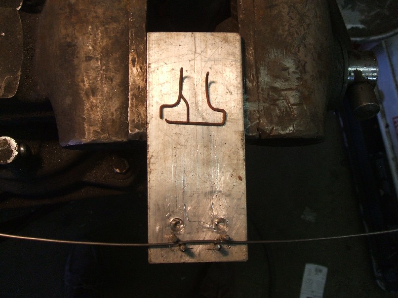

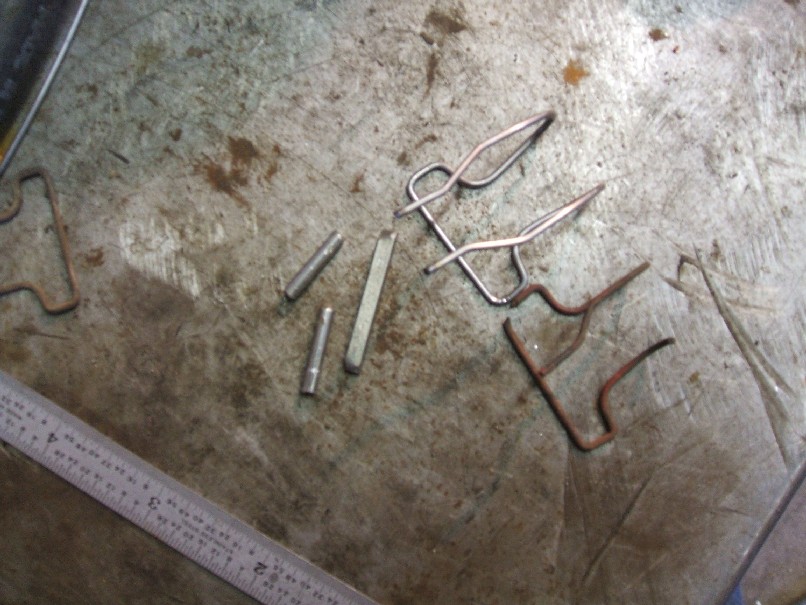

                        Have two hoods for my M16 but both had broken return springs for the 'hood' safety latch...can't drive it without undue danger of the hood flying up. The attached pics show how the replacement was made. The org. spring was .055 wire, I have .059 so that is what was used. Drilled 1/8th and 1/4 holes, in the proper positions, in a piece of scrap aluminum block. The first pic shows that block with some 1/8th pins inserted and a piece of the .059 spring wire in it's first position. On top of the block is also a broken original spring that is being reproduced. The next shows three bends having been made; the last with 1/4 inch pins. The last big bends were accomplished using a 3/8 diameter pin [a handy 3/8 bolt laying nearby]. The 3/8 pin was clamped on the top of the long straight legs of the partially bent spring and then bent around it. No other tools were used...just the fingers to bend the wire around the pins. Then the completed spring and some old broken ones. Last is a view of the open hood with the new spring installed. Anyone need a spring for a M16 or M15 and [I think] an M5 safety hood latch? They will be free as it's a piece of cake to make a few more.
                        I submit this with the idea that showing how easy it is to make somewhat complex springs that no one will be afraid to do it. If it took skill or patience I could not do it. Lots of spring wire is available at hobby shops.
