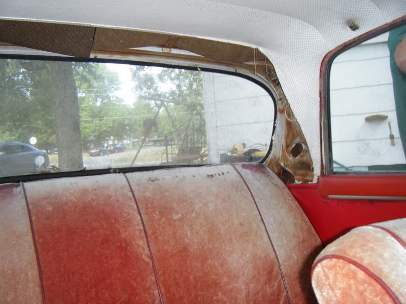

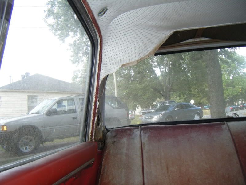

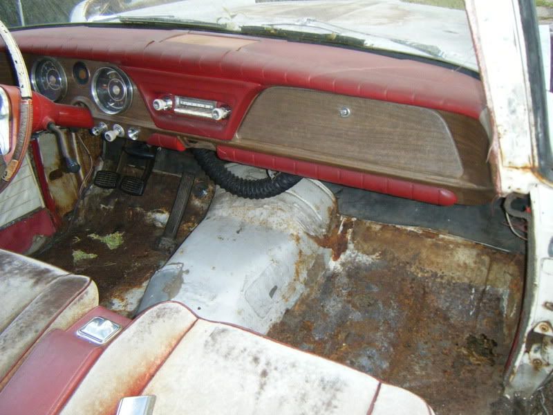

    Bams asked for some pics of the inside...like I said she's a little rough. but I think I can work with her.
    Please let me know if I'm posting too many pics.[:I]
    I've adjusted the size down a notch on these.
    Howard gave me new front and rear pannels, and 2 new seat covers for the front...I just need to get a rear cover, new headliner, floors, carpet, floor mats, and...[)]

      It looks like you have a pretty solid car other than the front floors. The good news appears to be that the door pillars are still connected to the floor and rocker metal. Replacing the floors will hopefully correct all of the structural issues.
      All-in-all it looks like it will be a nice driver.

        For some of us there's no such thing as too many pictures... and I'm on dial-up[8D] Thanks for 'em! That over-faded cheapo velour will disappear quickly and REALLY improve the inside. That dash looks SUPER! Is it as good as the pictures show??

                    As far as I remember the dash pad only has the 2 cracks that line up with the radio knobs.
                    Is the patch in the floor stock, or did someone botch a floor shifter? I would actually prefer a floor shifter.
                    Before the interior or exterior gets done, I need to get all the mechanical and electrical systems working. Then once she proves to me that she runs, she'll get her face lift and a tummy tuck![^]

                        The dash pad's no biggie, easy to get a rebuilt one from Jim Lawrence. I'm more interested in the metal woodgrained area. How is that??

                          You don't need a 4x8 sheet of steel. All I see is 2 small patches Clean it real good with a wire brush spray phosphoric acid on it and leave it about a hour neutralize it with water and a little vinegar let it dry and put POR 15 on it. Get the 6 pack of small cans the quarts go bad before you use it up. You will have to top and bottom. You can take fiber cloth you put the POR 15 lay the fiber glass cloth down on the wet POR 15 with a sponge brush and then put another coat on top of that. Have a good strong floor board. Remember it took 50 years to get that way and I don't think you will have it 50 years from now.

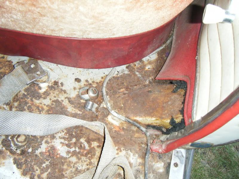

                            The pictures are a little deceptive. The hole in the driver's floor was much larger after Fred got in the car! Still not too bad, but the rust is concentrated right where the body bolts to the cross member so it needs to be sturdy.

                              Yeah those pictures of the inside were taken in August...the hole is big enough now for a cat to get in and out.[V] But if I route the exhaust pipe just right it could be a good heater for winter![^]
