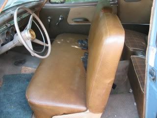

    This car is a recent aquisition of an online aquaintance. He is trying to assess what his abilities with it are at the moment but he and I would both like to know what if anything is not correct. I am pretty positive the hubcaps are wrong and maybe the wheels. The seats look odd to me,are they correct? He hasnt been able to get either the hood or the trunk open as yet but will send more pics when he can. He will also send floor pics. Opinions? Steve (sorry, didnt check the sign-in)

      shewolf.. be very careful opening the hood for the first time. The lever is in the grill on the drivers side, just to the right of the nose of the hood. Pull it toward you to release the latch. When you open the hood, pull the hood directly toward you while pulling up slightly. This is important so the hood corners do not bend. Please do this gently until you get the hang of it. Then, when you get the hood open, oil the hinges at all points before you close the hood again. The car looks fabulous. The wheel covers are not correct, but its difficult to know of the wheels. The seats appear to be correct, but the upholstery is suspect. Looks like a great car. Good luck.

          The rear seat has a seat cover over it, and may be original under it.
          The front is reupholstered in a plain Vinyl instead of the pleated inserts it had.
          These seats were kind of a 60/40 with the drivers' side being smaller to allow easier entry to the back seat on the right (curb) side.

                  I could be wrong, but I dont think the plad in the back seat was a factory option. Again, I could be wrong, but I have never seen one.[?]

                      The seats and hubcaps are both wrong. However... the top of the back seats seem to match the doorpanels.. so...

                        Mine had a similar plaid pattern cover over the original on the bottom half of the seats that was blue. I am sure they were installed by a local Stude guy in the 70's when Dad originally owned the car. It might have been from a later model but it was definately custom fitted for the stude seats. I also dont remember how they attached but remember it being a very simple assembly. Steve

                            I have a Studebaker Dealers' Accessory Seat Covers book which shows a number of different plaids. From the aging apparent on the cover I agree that the rear seat may very well be original. The cloth seat material has been impossible to find for many years so it will be interesting to see what the condition is if they are original.
