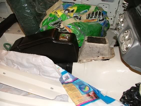

    Try it again...the parts don't match up...can someone advise where we went wrong

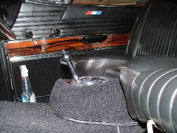

        That can't be the right tower for a powershift Hawk, or the console is wrong. The rear side that is next to the console needs to be right next to the console, then there is a carpet piece that surrounds the tower and snaps to the console.

            I am installing a power shift in place of a 4 speed and the shifter tower should fit up to the console, which it doesn't, by several inches...I was led to believe the console and the tower are from a Hawk..but maybe not...it should be a flush fit as per the attached pic..

                Thanks Tim..
                I think you are right!!...so now to find out which piece is the wrong piece...

                            Barry, it appears that you may have a "Lark" type console. The front of the GT console slopes forward which matches the shift tower.
                            A factory power shift console will have snaps for the carpet. The parts book only has one part # for GT's other than color. Black is
                            1344936X11.
