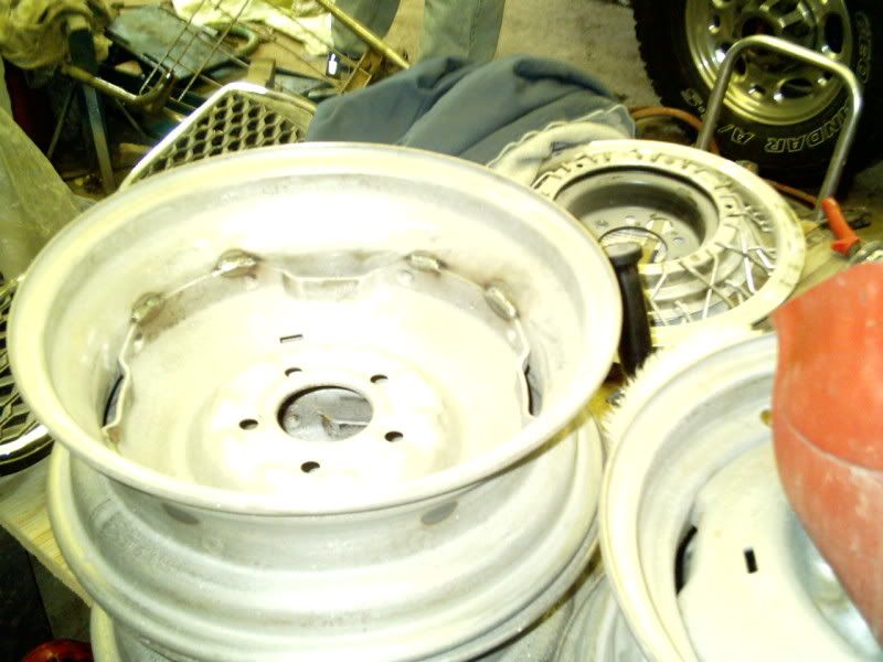

          Check about half-way down the page on this link: http://forum.studebakerdriversclub.c...rms=64,Daytona It should take you to a picture of a Stude wheel with crack just starting. I have had worse, like Monomaniac describes. Scary stuff, and I agree with using new rims 100%, unless it's with repro bias tires on factory rims for a gently-driven "show-only" car.
            This topic always gets my intrest when it comes up, maybe it's because my tires were considered offenders,
            Without getting into the debate of weather or not its safe I went out today and cut a cross section of the old tire I had.
            Now mind you I couldn't break the bead, these tires had been on there so long a sawzall was used on the sidewalls and then angle grinded the steel inner cord as I pryed a screw driver against the cord and rim.
            These are General brand tires from say 1989 205 75 15 radials, never came off, and no cracks others have mentioned ever on these wheels, and I believe I drove it regularly for 11,000 miles 61 lark sedan.
            Fell free anyone to save photo's for their archives.
            Bead still secured to each side (had to sawz all tire off
            cross section after angle die grinder/cutter treatment.
            ChopStu
            61 Lark
              The rims that Studebaker used tend to flex, which can lead to cracking. I would check ANY original wheel that will be used, no matter WHAT tire is used! [:0] Ask a local auto machine shop how to test your wheels.
              For a daily driver, new rims are best.
