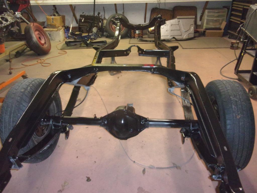

      • #33
        It hit 70 today in Tulsa so I took advantage of the weather and shot the first round of SPI epoxy primer. Mixed it up in the morning so it would have at least four hours of induction. The parts that had not cleaned up well with the commercial chassis sand blasting was blasted again with my Harbor Freight sand blaster. That little thing gave me fits for some time until I started using what they call white sand in it. It is the consistency of table salt but has never jammed up on me. It does a very good job for what I need it to do.
        I rolled the chassis out of the garage like a big wheel borrow and hooked the front end up to the engine puller and cranked it up pretty high so I could get back to the leaf springs underneath. The control arms, coil springs and batwing were painted separately. I got three coats on what I could reach and tomorrow I will lift the rear end up so the underside of the leaf springs and frame can be painted. I rolled it back into the garage and set two electric heaters to keep it above 60 overnight. It is supposed to be 60 or so tomorrow so I have to take advantage of this unusually warm weather that the good Lord has provided. It is supposed to snow Saturday.
        Charlie D.

        • #34
          I dropped the rear end and springs on mine and set it up on two saw horses bottom side up then and painted that first then using a cherry picker after that side was dry just flipped it and shot the top side. Worked out good.
