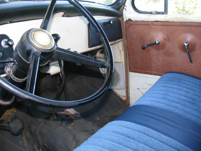

                  I have the same "C" Cab as your '57 in my '62 1 Ton, it had the Original "Transtar" Delco Radio under the dash on the Left of the Column.
                  As you can see the Speaker goes in a Metal Box on the Right Kick panel.
                  Click image for larger version  Name:	IMG_0207.JPG Views:	0 Size:	50.2 KB ID:	1836276There really is not a actual "Bezel" except the Chrome Faceplate of the Radio not easily removed.
                  The "Mounting Plate" was a simple flat piece of Quilted Aluminum with curved ends to help hide the exposed Radio.
                  The R Series '49-'53 and '54 to '56 Mounted IN the dash but '57 to '64's do not.

                  This does not work on "C" Cabs, as there is No "under seat"!

                    That speaker in Rich's friend's truck is the bottom of the radio box. Motorola made a Transtar radio by putting a Transtar label on one of their standard universal radios and some models had the built in speaker.
