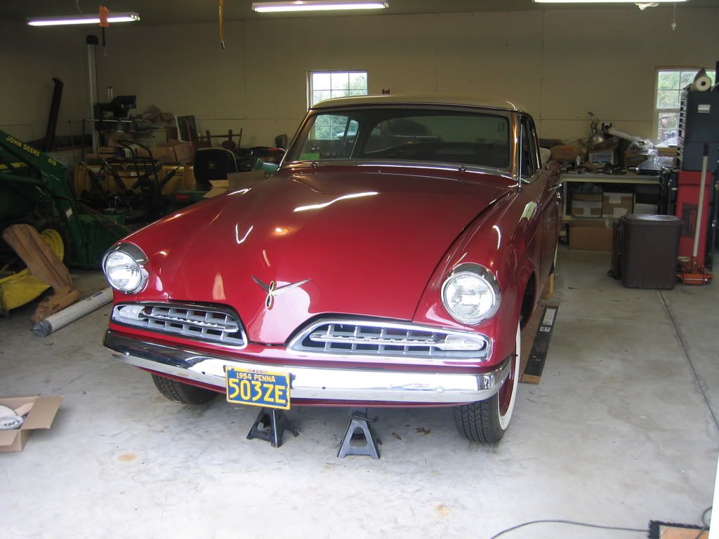

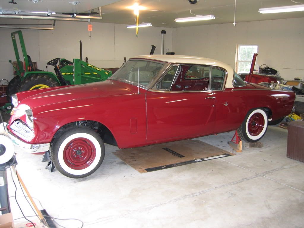

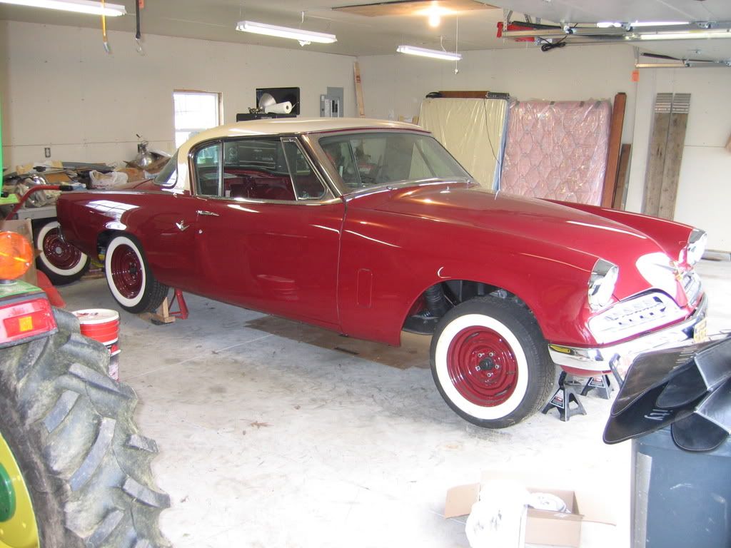

                          Hello everyone,
                          I took a few overall, hood-down pictures of Grace this morning -- about all I can do with one hand still wrapped.
                          Notice that the center of the hood seems to be sitting up too high. Any ideas how to fix this?

                            Looking Good. Vary nice.
                            Is it latched?

                              This car is looking excellent
                              Makes we want to get some WWW tires on mine instead of the sorta WW I have. What size rims (see they are not the originals) and tires do you have?
                              As for the hood thing, I assume you mean at the front where the latch is? It seems that most don't fit the best there, including mine. The grills seem like they should be higher in the center along with the sheetmetal behind them. However, at least on my car, there was no way to adjust this and it even wants to pull down lower than it is. I had to add a stack of washers with a longer bolt to the vertical brace that runs from the bottom of the filler panel above the bumper to the air dam under there as if I tried to install it without extra length, it was pulling the center down even more. I sort of chalked it up to the panels being a little off as I had to straighten various used parts from several cars when I was doing the restoration. HAving seen more cars in the last few years, it does not seem to be a uncommon problem. I have seen a couple of cars that fit MUCH better, but I don't know what they did differently. Even some factory pix you can tell the gap is fairly big.
