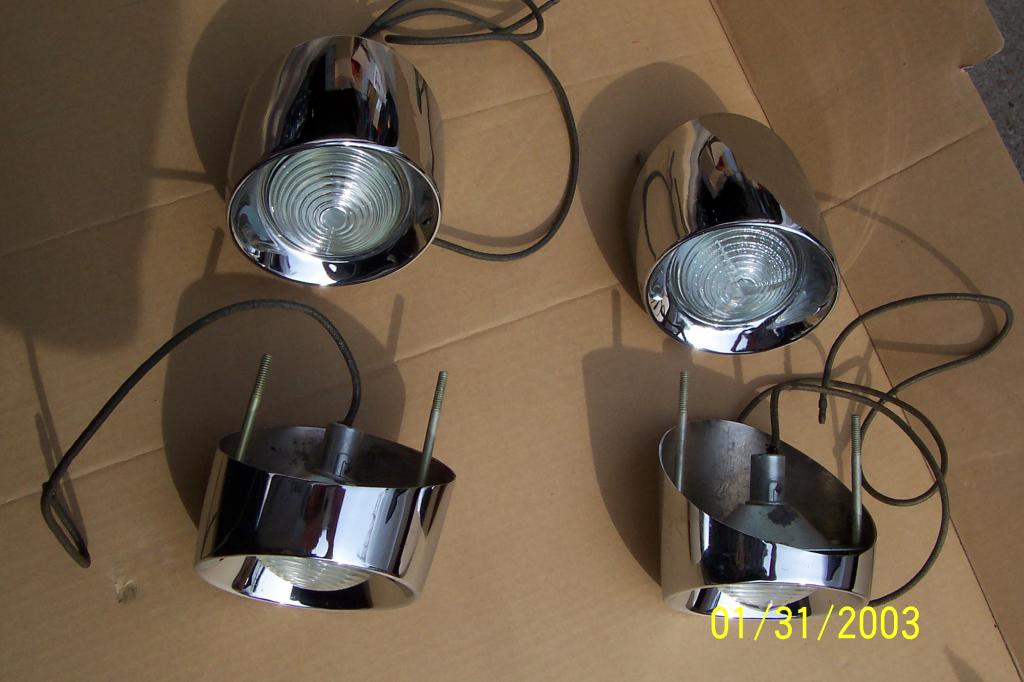

    Can someone please tell me which pair of backup lights is for the C/Ks and which is for the sedans? The left side is a pair and the right another pair. The right side has the star in the glass lense. Another difference is the depth as shown on the bottom lights. Part numbers are on the boxes are AC-2331 (C/K) and AC-2333 (Sedan). I want to put them in the correct boxes. Thanks.

    The point is to have the light's lens vertical. Since the C/K trunk lid is sloped more than a sedan's in that area, I believe that the pair to the right is for C/K.
    If someone has a trunk lid and/or known lights, that would be better for making a determination.
      No doubt, Gary is correct, as usual. It's easy to see, even in the thumbnail, with just a glance! ones on the right are the C/K's and those on the left are the sedan version.

        Yes , you are correct.The right side is C/K.
          Yes; the pair with the shortest depth at the bottom fit C/K models.
