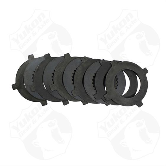

          The Studebaker TT unit is a Dana Power Lok two piece unit. They also made a traction lok one piece unit. They are completely different. Nels is correct about the center thrust pin. It is a two piece assembly held together with a spring pin. The spring pin is the Achilles heal and it can fail. Also with enough torque, the separating forces can be greater than the yield point of the bolts holding the two halves together. When that occurs, there no longer is any clamp load and the two halves move/slip. In a short time you will shear all eight bolts. Over the years I have sheared the bolts in both a Dana 44 and a Dana 60. Dana made a Power Lok to fit the 55 - 64 Chevrolet rear end. The same failure occurred there especially in 409 cars. Try this for an internal clutch kit. http://www.drivetrainamerica.com/222...4aAqWXEALw_wcB
          or
          Free Shipping - Yukon Gear & Axle YPKD44-PC-AG with qualifying orders of $109. Shop Differential Carrier Clutches at Summit Racing.
          I am assuming the pinion shafts, differential pinions, and side gears are okay.
