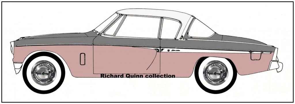

        Slightly off-topic but some months ago I scanned in a line drawing of a side view of the Speedster and after some work in photoshop adapted it so as to be able to illustrate the various color offerings for this special model. This is the Shasta White - Pimlico Gray - Coraltone combination.
