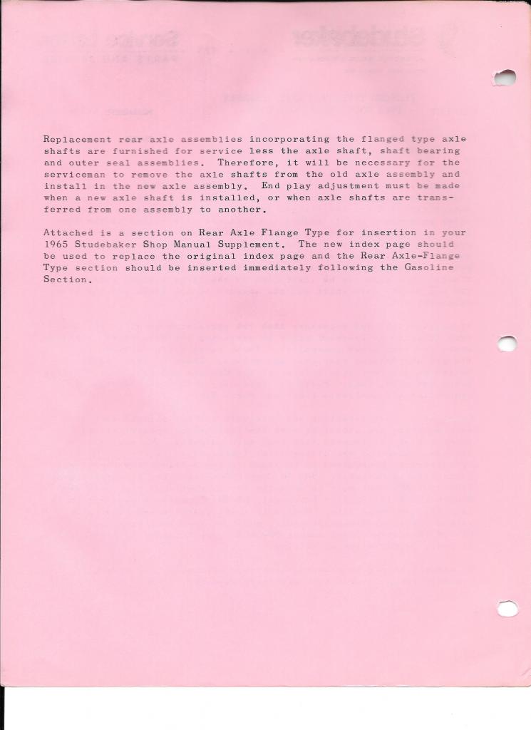

    If that was ever published, I missed it. This is all I have:
      Sometimes the parts chassis books give info on changes by before and after serial # s
        R3 cars had flanged axles way before the rest of the line. They were totally different than the 65-66 type however, and wont interchange.

          I did check the '65-'66 Parts Catalog to be sure, but no luck there.
          As the Service Letter explains, there are NO Serial Number breaks for the change to flanged axles, and they recommend the obvious; pull a Hub Cap or Wheel Cover and LOOK!

              We now know that any April 1965 and later Build dates are guaranteed to have Flanged Axles.
