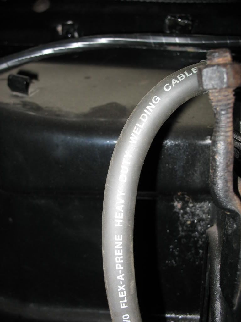

                  We have an long-time battery shop in town. They remanufacture and sell new batteries. And CABLES. Used 1/0 Flex-a-prene heavy duty welding cable. Less than 10 minutes. With professional crimp terminals. Less than $10. [^]
                  [img][/img]
                  [img][/img]
                  He can do the flat braid, too. But I think he complained it comes from China now. [}]
