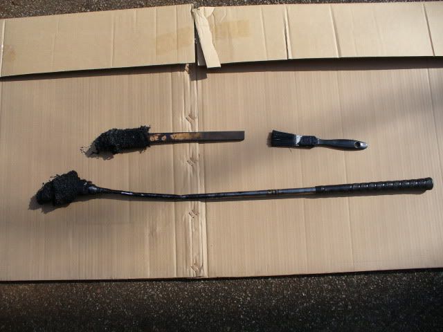

    Now to Ernie's advice. He had suggested drilling holes in the floor above the hog troughs and using POR-15 on the inside. I grabbed the 3 1/4" hole saw and "After Swallowing Hard" put it to work.
    This what it looks like.
    Here are the tools I fabricated for the job. Yep, That's why it's in the tech section.
    "TOOLS"
    I made sure I cut the head off the driver in front of the rest of the golf clubs after I explained they would be next if their ball striking did not improve. I also cut up an old golf towel and zip tied it to the end.

    Best use of golf clubs I have seen in a long time.
